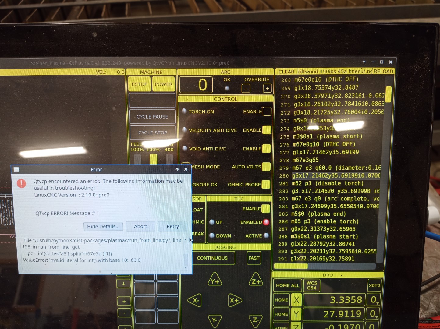

Issue: "Run From Line" works fine unless trying to run from a line AFTER a g-code line that looks like this:
(slow down to 60% for a small hole)
LinuxCNC 2.10.0~pre0
Running on MX Linux 21
Using qtplasmac
Debs built from code pulled roughly 2 weeks ago; I don't have the exact Git rev number handy.
Gcode generated by Sheetcam TNG Development 7.1.28 (I see 7.1.29 is now available)
The full traceback:
Sometimes typing something out helps you to see the obvious that you missed while looking at it the first time. Seems to me the complaint is that an int is expected, but a float (60.0) is received? Is this a Sheetcam post processor issue, or something that could be tweaked in LinuxCNC code to accept ints or floats? Perhaps I'm way off base here. I dabble in python but sure don't write code every day or anything.
I'm not in my shop now or I would experiment with removing the .0 and see if I can Run from Line successfully then...
m67 e3 q60.0LinuxCNC 2.10.0~pre0
Using qtplasmac
The full traceback:
File "/usr/share/qtvcp/screens/qtplasmac/qtplasmac_handler.py",
line 1714, in run_clicked
data = RFL.run_from_line_get(self.lastLoadedProgram,
self.startLine)
File "/usr/lib/python3/dist-packages/plasmac/run_from_line.py", line
158, in run_from_line_get
pc = int(codes['a3'].split('m67e3q')[1])
ValueError: invalid literal for int() with base 10: '60.0'Sometimes typing something out helps you to see the obvious that you missed while looking at it the first time. Seems to me the complaint is that an int is expected, but a float (60.0) is received? Is this a Sheetcam post processor issue, or something that could be tweaked in LinuxCNC code to accept ints or floats? Perhaps I'm way off base here. I dabble in python but sure don't write code every day or anything.

So I went out to my shop and experimented some more. If I'd not be so rusty with coding I'd have noticed the quotes around '60.0' meaning it's a string... anyhow, so I decided to modify the code to first convert the string to a float, then convert the float to int, and now my Run From Line works as expected in the file that was giving me problems! The (very slightly) modified line is below:
I'm not experienced enough to know if this is an acceptable fix or if it's a cringeworthy hack.
An interesting observation I made also (probably no news to qtplasmac gurus) is that nowhere in my original gcode file is a line found containing "m67 e3 q60.0". It appears that QtPlasmac runs some logic that replaces certain lines with directions of its own when a file is loaded. The closest I can find in the actual file output from Sheetcam is the following:
And from that, the file loading process in qtplasmac creates the offending line, m67 e3 q60.0
# Line 158 of /usr/lib/python3/dist-packages/plasmac/run_from_line.py
pc = int(float(codes['a3'].split('m67e3q')[1]))I'm not experienced enough to know if this is an acceptable fix or if it's a cringeworthy hack.
M67 E3 Q65And from that, the file loading process in qtplasmac creates the offending line, m67 e3 q60.0

Thanks for finding this bug.
A float is valid for an analog pin so the int is incorrect.
linuxcnc.org/docs/devel/html/man/man9/mo...9.html#MOTION%20PINS
The following concerns me though, is it actually changing the value?
There is a filter program named qtplasmac_gcode that the gcode file is run through when loaded.
M67 E3 Q65

I made a quick program to test this out, and neither the original load nor the Run From Line load change M67E3Q65 in any way except it makes it all lowercase... m67e3q65.
Can you post the G-Code file you are working with? And also, can you tell us what line you are attempting to RFL on, etc? That would probably help narrow down what is going on (other than the string to int conversion).

At Line 274 of this file, you will see M67 E3 Q65. But a view of the code in QtPlasmac looks different, the line numbers don't match and there's the line with the 60.0 float described above. In this picture you'll observe the "m67e3q65" line at 278, and line 279 isn't found in the gcode file. Trying Run From Line for any line greater than 279 resulted in the Python traceback.
Gcode file attached in the exact form I ran it, below.
PS. The qtplasmac version is visible in the picture, v1.233.249
Attachment not found

The extra lines are because at line 14 you have:
Which turns the automatic hole processing on.
linuxcnc.org/docs/devel/html/plasma/qtpl...html#qt_hole-cutting
The string to int is a bug, thank you for reporting it
#<holes> = 2 Which turns the automatic hole processing on.
Last edit: 20 Dec 2022 14:55 by snowgoer540.

A fix has been pushed for the string to float conversion. As soon as the buildbot does its thing, you should be good to go.
