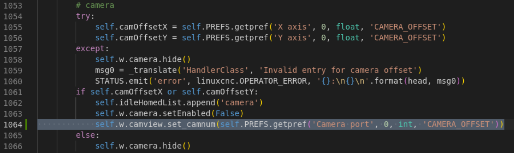

I spent some time with my long USB cable and the Supereyes camera this evening. I can display a video feed from the camera in VLC player just fine. However, when I hit the Camera button in QtPlasmaC, it uses the computer's built-in webcam. (I am using an older Dell all-in-one computer, which is just laptop-grade hardware and not optimal but it was a cheap way for me to get a touchscreen.)
In VLC, the built-in webcam is /dev/video0 and my USB camera is /dev/video2. How can I specify which camera is used by LinuxCNC rather than allowing it to pick system default? I tried, so far unsuccessfully, to disable the built-in camera via udev rules.

Are you running LinuxCNC from a package or from a run in place build.
- caretech
- Posts: 65
- Thank you received: 26
27 Jan 2023 12:22 #262999
by caretech
Replied by caretech on topic Camera setup
I'm running a package install.

If you want you can try the following.
You could edit the handler file /user/share/qtvcp/screens/qtplasmac/qtplasmac_handler.py
and add the highlighted line, you need to be root user to do this:

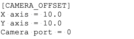

When you run QtPlasmaC then it will add a camera port entry to the [CAMERA_OFFSET] section of qtplasmac.prefs in your config directory.
Close QtPlasmac
Edit qtplasmac.prefs and change the number to suit the required camera.
Restart QtPlasmaC
I don't know if the python3-opencv camera numbers map the same as VLC numbers so it may be a bit of trial and error. My test rig has the same numbers for both but they are reversed...
If it works OK for you we could add something like this permanently.
Close QtPlasmac
Restart QtPlasmaC
