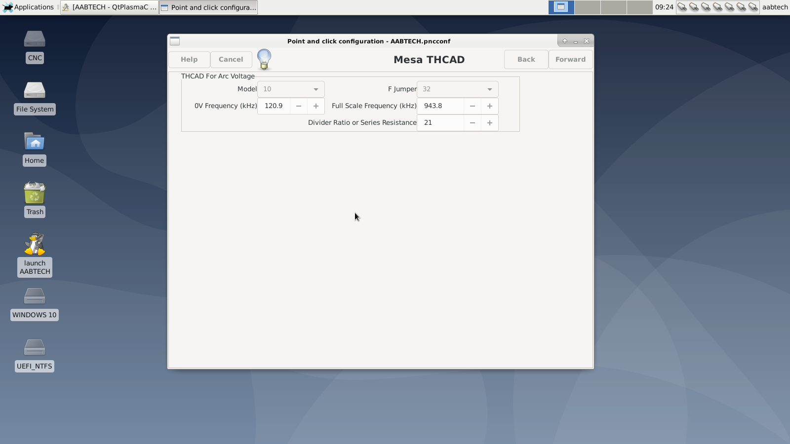

Hi, linuxcnc family i have 7i96s and a THCAD-10 and my setup is not working.
i am using 1 Moh 5w power resistor 1 for each leg from the plasma direct to the THCAD-10 which will give you divider ratio 21
by the manual.
But the Z axis is not moving up and down. and if i start a job the touch will be on but it wont move. and this my settings
by the manual.

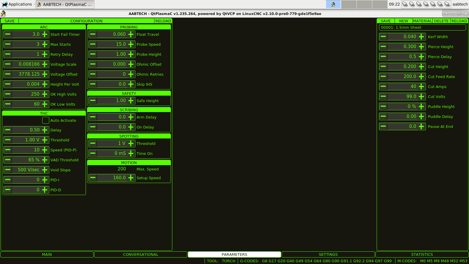

08 Feb 2023 17:07 #264066
Replied by tommylight on topic THCAD SETUP
Upload a screenshot of QtPlasmaC while cutting.

08 Feb 2023 21:59 #264079
by snowgoer540
Replied by snowgoer540 on topic THCAD SETUP
in addition to what tommy requested, uploading a backup of your config, created from the settings tab goes a long way in helping us help you.

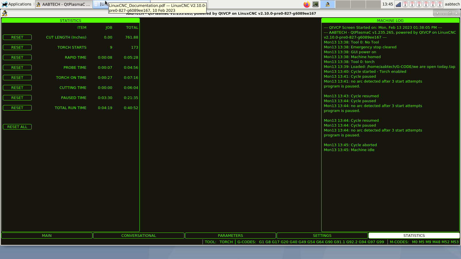

hi, any help about my THC arc start but machine not moving when stating a job.
Screenshot while the machine is cutting?
Or a video?

I know tommy was waiting for a screenshot of the machine while it was cutting.
I was waiting for a backup of your confing (linuxcnc.org/docs/devel/html/plasma/qtpl...c.html#plasma:backup). The hal and ini files don't really tell the whole story here.
It would also be helpful if you could upload the gcode for whatever it is you are trying to cut. There are plenty of g-code related things that if inadvertently set incorrectly can cause you grief as well.

i was finding it difficult to up load a video so i compressed a shot video and zip it.
