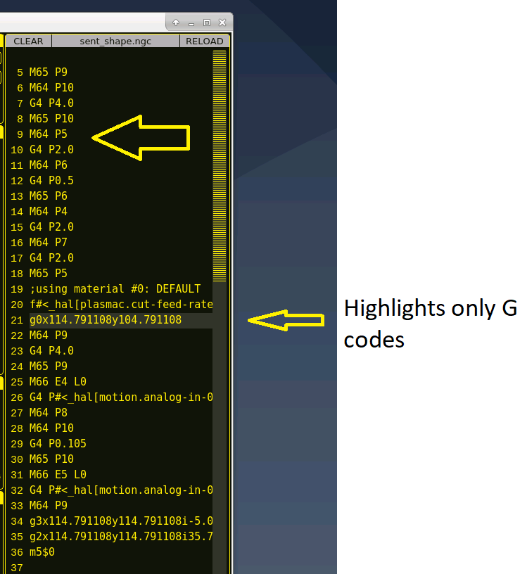

Hello.
I use dev Linuxcnc Plasmac 2.9.0~pre0.8052.g924f12f53. Faced the problem of displaying the current executable line. I need additional M codes for my machine to work. So when they are executed, the status bar freezes and resumes the display when the G codes are executed. Can anyone tell me what settings need to be activated in the G-code widget?
Regards, Dmitry.

Replied by snowgoer540 on topic Problem with displaying the currently executing line.
I think has to do with the linuxcnc gcode interpreter.
This ties into single block discussions. Two such example threads are:

17 Mar 2023 16:23 #266919
by snowgoer540
I was attempting to articulate that you can't change the behavior without rewriting core linuxcnc code.
self.w.gcode_display.moveMarker(0) comes from the qtplasmac_handler. It is part of the run from line line selection code. (not what you're after).
The line marker movement for qtplasmac is handled in the qtvcp gcode_editor widget. The signal is connected at line 599 and passes the emitted line information to the "external_highlight_request" method. The line information is emitted from line 496 of hal_glib.py. Walking further backward, self.old is populated from self.stat.motion_line, which comes from the emcmodule.cc python interface (here) . task.motionLine is created here (notice that it says "line motion is executing-- may lag". And finally, motionLine gets populated here .
Hopefully that helps.
