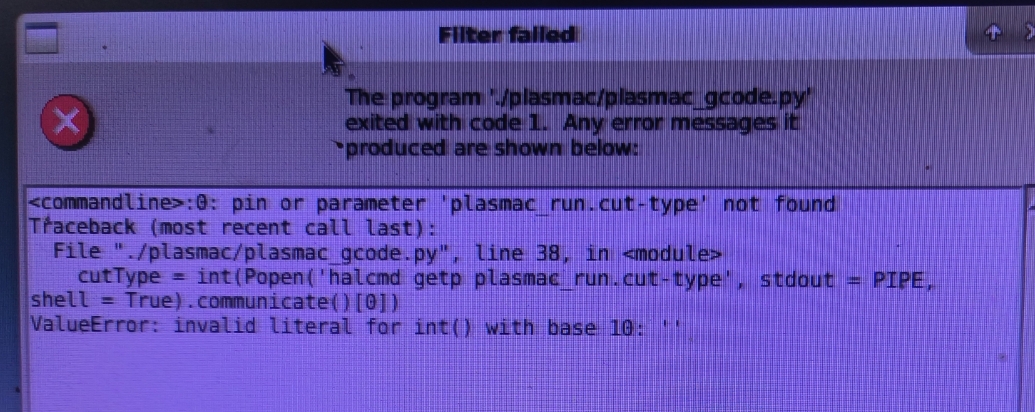

Hello, i use Plasmac as well, i shutdown the pc, and after i need to use i receive the error in the picture. Where is the problem? Thank you.I use linuxcncwith axis 2.8.0 pre 1-6199-g9bdae7cf0

Is it possible for you to do a Backup from the Config panel and post the resulting file here.
Edit: Are you trying to open a file on startup, because that is not possible, you need to have OPEN_FILE = "" in the ini file [DISPLAY] section.

Thank you for answer. I solve the problem. Before turning off the PC, I accessed the .ini file and by mistake I copied 2 lines with the mouse and moved them below. Hence all the problems....
