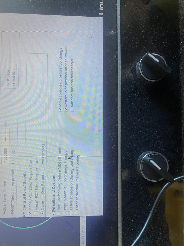

I have a few questions with a qtplasmac, Although I have all three axes home sensors configured, and the option not to require homing before MDI, it still requires that I hold in the machine every time I turn it on. How can i override this?

If you have a HOME_SEARCH_VEL = 0, and HOME_LATCH_VEL = 0, and HOME_USE_INDEX = NO in your INI file, then the axis will home immediately in place, for each axis you set this way...
You will still have to press HOME ALL on the GUI.
If you post the INI file, we can help you if you are confused.

thank you. i have my config files here.

The attached should home in place for you.
Edit: I should note to be careful as this will throw off your soft limits.
