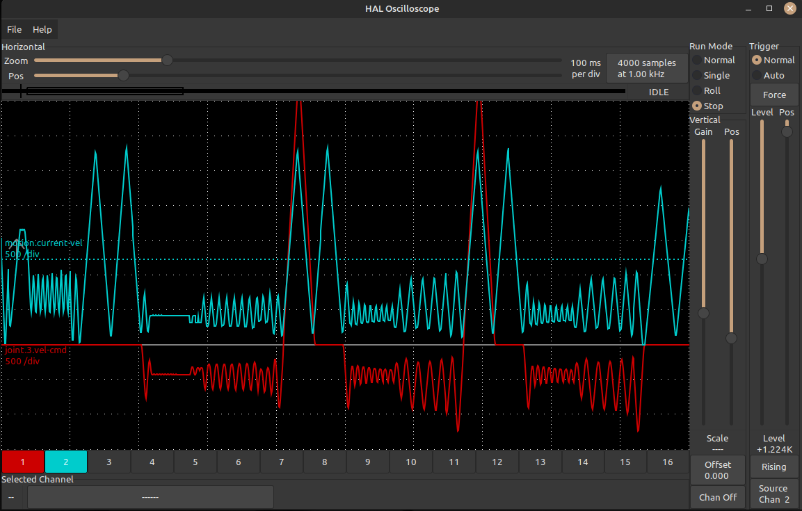

With max acceleration of 50000 and max velocity of 12000 the very best I could get on the standard code was 10500. The last corner was only 4380. These numbers are from motion.current-vel using hal sampler.
The result is attached, column 1 is joint.3.vel-cmd and column 2 is motion.current-vel.

Not even close...@phil as a sanity check: Are you able to actually have a simulation go at 20'000mm/min?

The problem seems to be that you would need insane acceleration values to reach feedrates of 20m/min with the one line look ahead. And of course the shorter the segments the higher the acceleration would need to be.
It's like driving on a road in fog, because you can't see what lies ahead you can only go so fast so you can react to changes. The thicker the fog the slower you go. Unless you could brake/speed up instantly, of course.
So, as I see it at least, this is beyond what LinuxCNC can do in its current state.
