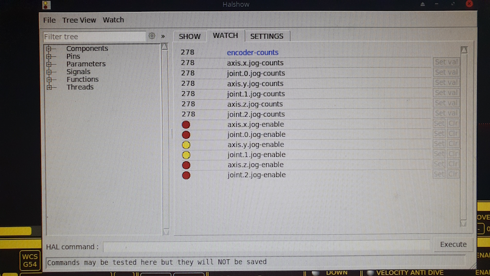

Using a Qtplasmac config with a 7i96 board with hal file generated by PncConfig
I've hooked up a microcontroller programmed as an encoder emulator, to the 7i96 board.
All this encoder emulator board does is give out A & B quadrature signals at different frequencies (to give different jog speeds).
The only other extra signals I have are from a 3 way selector switch to select either X, Y or Z jog-enable.
The 7i96 is flashed with the 7i96_p1inmd.bit file which gives extra encoder reader inputs on the P1 expansion port.
Wrote a very basic custom hal file - no ilowpass, etc, just the bare bones for testing.
The code is:
net encoder-counts <= hm2_7i96.0.inm.00.enc0-count
net encoder-counts => axis.x.jog-counts joint.0.jog-counts
net encoder-counts => axis.y.jog-counts joint.1.jog-counts
net encoder-counts => axis.z.jog-counts joint.2.jog-counts
net jog-enable-X hm2_7i96.0.inm.00.input-02-not => axis.x.jog-enable joint.0.jog-enable
net jog-enable-Y hm2_7i96.0.inm.00.input-03-not => axis.y.jog-enable joint.1.jog-enable
net jog-enable-Z hm2_7i96.0.inm.00.input-04-not => axis.z.jog-enable joint.2.jog-enable
I used Halshow to see the encoder value increase and decrease with FWD and REV directions.
Likewise all jog count pins for X,Y,Z axis and 0,1,2 joints incremented / decremented together with the encoder count value, so all seems to work perfect there.
Likewise the X, Y, Z jog-enable and 0, 1, 2 joint jog-enable pins activate with the corresponding selector switch positions.
So I have one of the jog-enable signals active and the encoder counts working.
Why does the axis not respond, am I missing something in the hal file.

Are axis.N.jog-scale and joint.N.jog-scale being set to the correct value?

That's interesting Phill.
Are you saying I MUST include them in the hal file and give them a value ?? i.e. jog-scale does not default to a value if it's not in the hal file.
Saying that I just looked in the docs and there's no mention of any default.

Yes, that is the distance moved each count.

OK that's an easy thing to try.
Cheers Phill.
EDIT:
Well what do you know, I'm a dick. I actually looked back in my comments for the C coding in the microcontroller and there's me mentioning about setting a scale of 0.1 for the jog speed calculations (based on quadrature pulse rates), yet I forget all about that LOL.
Cheers Phill.

Couldn't find any jog-scale stuff in the hal files but I just stuck the following in my custom hal file regardless:
net jog-scale axis.x.jog-scale joint.0.jog-scale
net jog-scale axis.y.jog-scale joint.1.jog-scale
net jog-scale axis.z.jog-scale joint.2.jog-scale
sets jog-scale 0.1
and voila, everything worked perfectly. All axis, all jog speed settings, exactly as I'd programmed the microcontroller to do it. I'm over the moon.
