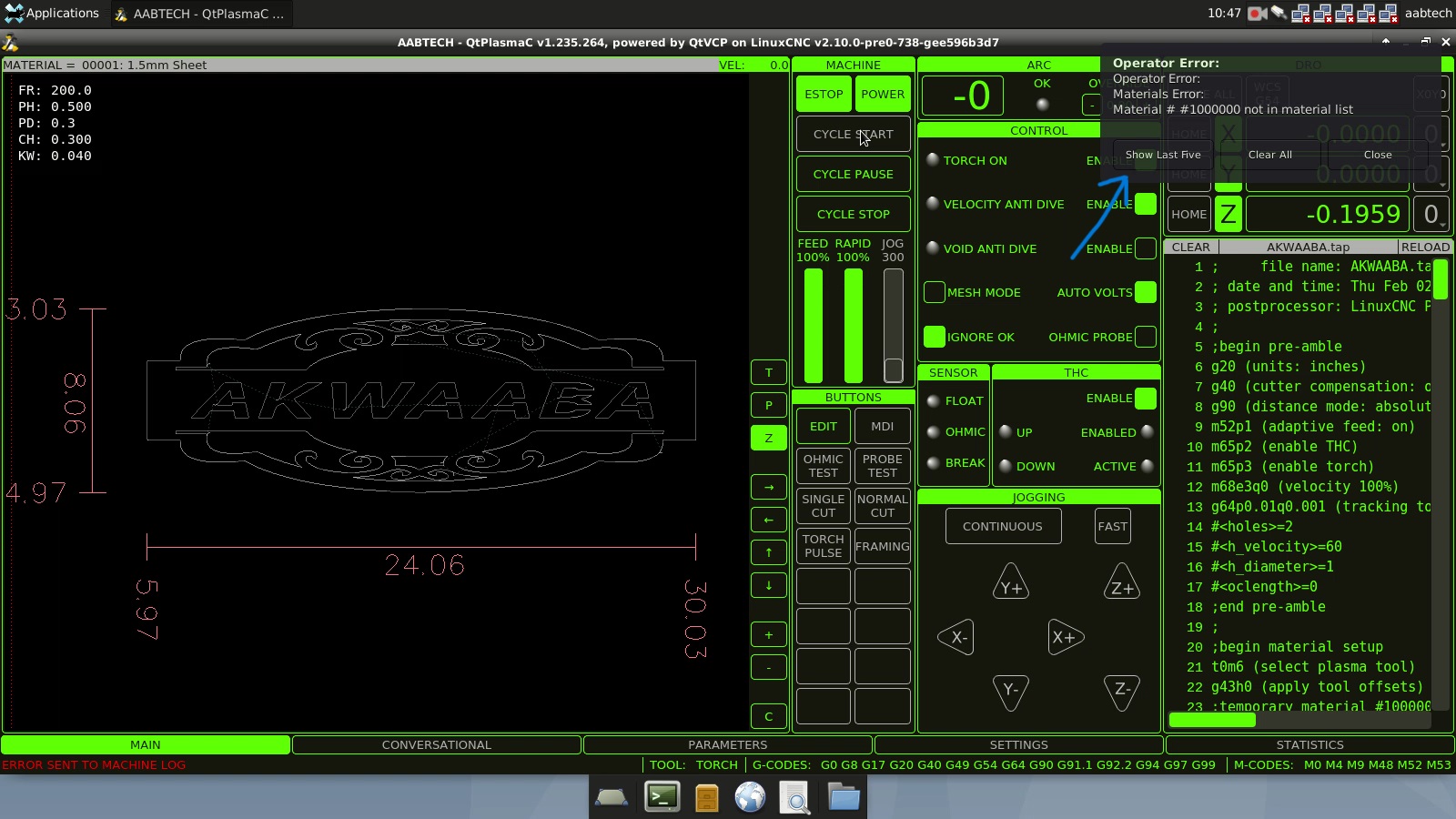

I apologize, I'd been away for the weekend.
You need to remove this line from your G-Code file, and then you can run it with any material you'd like:
Subsequently, if this is what you want to do with every g-code file, then you need to tweak the post processor options so that it doesnt use temporary materials. Or, remove the line each time.
Here's a video showing it working:
I attached the modified G-Code file to this post.
Lastly, your cut order in the G-Code file is a bit off. You should cut the features internal to the profile (circles and slots) before cutting the profile.
(o=0,kw=0.06, ph=0.5, pd=0.5, ch=0.4, fr=37, th=1, cv=99, pe=0, jh=0, jd=0)Subsequently, if this is what you want to do with every g-code file, then you need to tweak the post processor options so that it doesnt use temporary materials. Or, remove the line each time.
Warning: Spoiler!

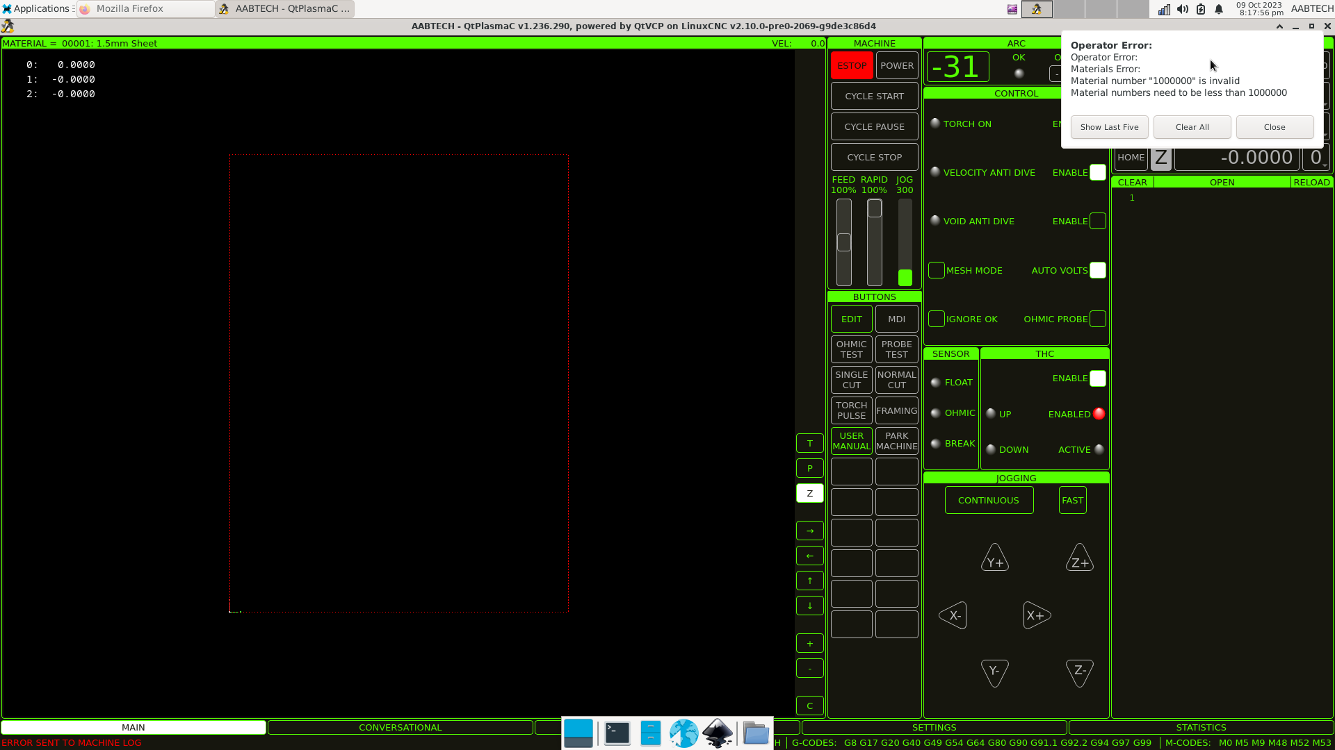

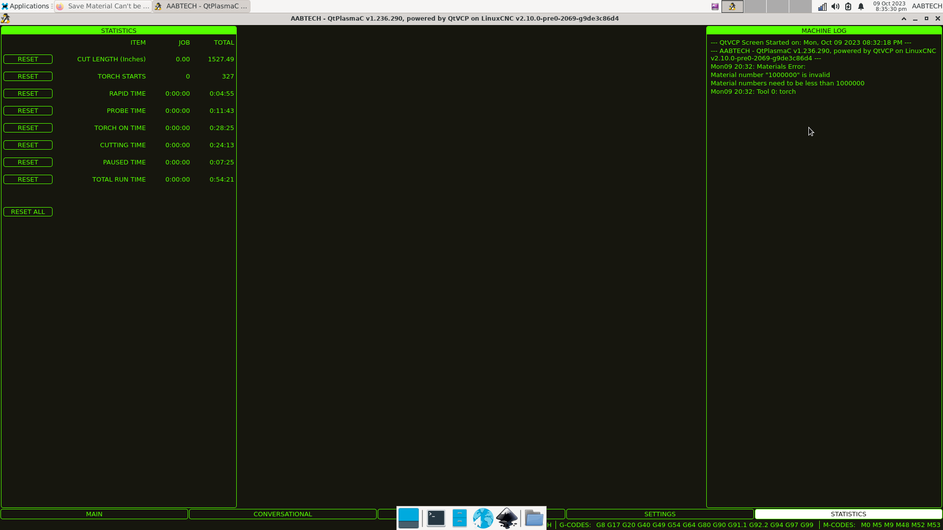

Looks like your material file may have saved a temporary material from when this wasnt working correctly.
Open your material file (<machine_name>_material.cfg) from your config folder and delete any materials that are ≥ 1000000
That should do the trick.

Now is working no error message
Thanks very much.
