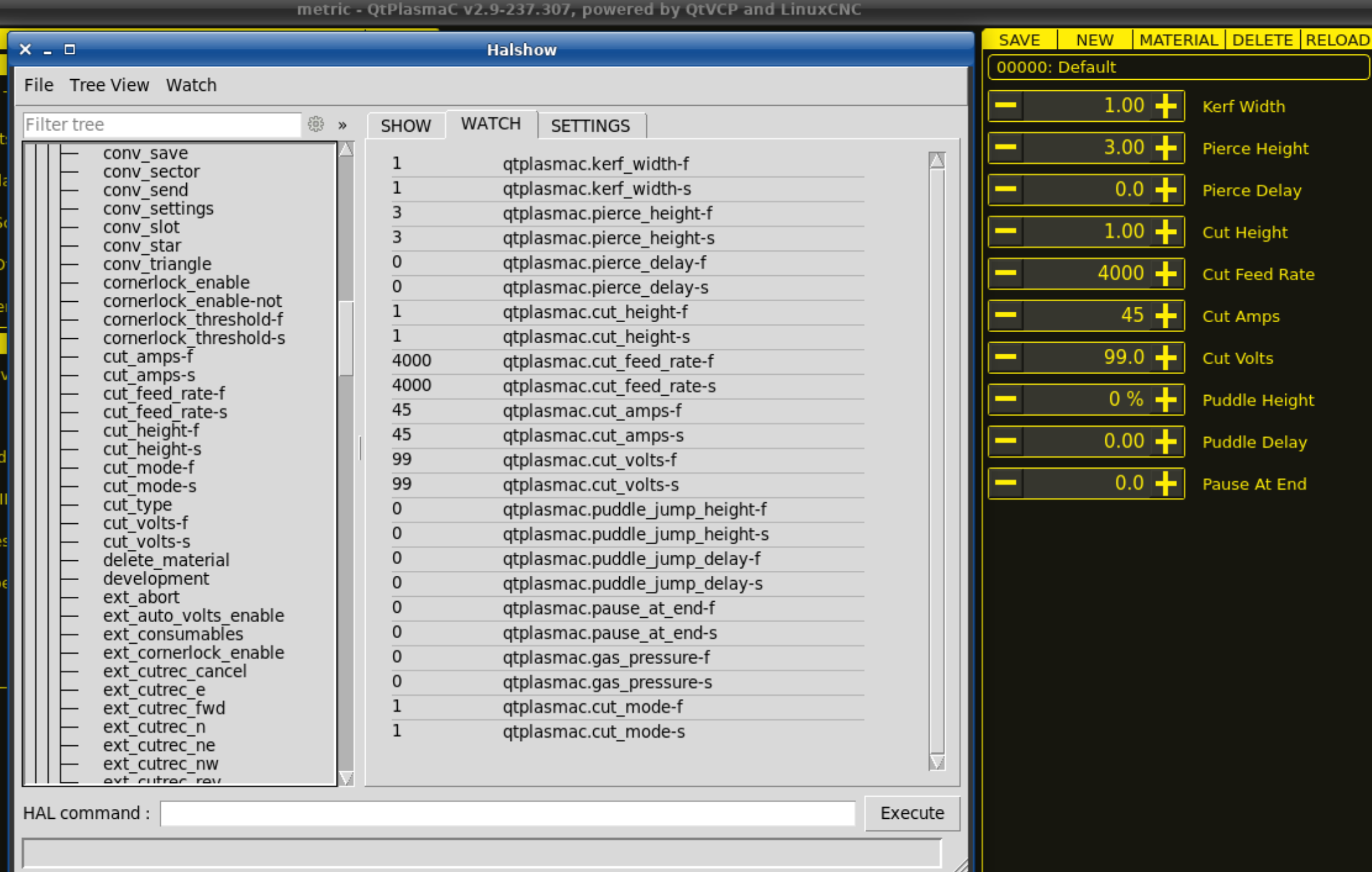

So I'm a little further along again
When I use volt it works like this:
net plasmas:cut-volts => hm2_7i96s.0.pwmgn.00.value
If I net plasmas:cut-amps => hm2_7i96s.0.pwmgn.00.value
I got the error: pin not found
That's right, I don't have a pin with the names in plasmac
how can I add this to plasmac?
King regarde and thank‘s

You need to use one of the names from this post:
forum.linuxcnc.org/plasmac/50468-qtplasm...utter?start=0#283780
probably the -f one which is a float.
Edit: I should have mentioned that you will need to net to the qtplasmac pin in a postgui Hal file.

hallo phillc54
My big thanks
in the custom_postgui.hal
net qtplasma.cut_amps hm2_7i96s.0.pwmgn.00.valuen qtplasma.cut_amps-f that working?
net qtplasma.cut_amps hm2_7i96s.0.pwmgn.00.valuen not working
you have 0 value displayet in the hm2_7i96s.0.pwmgn.00.valuen halshow…
king regarde and thank´s
juergen

Watching this thread, I was hoping you could do something like this in the gcode to use the configured material amps value (along with the spindle config above):
M3 $0 S#<_hal[plasmac.cut-amps]>
but from linuxcnc.org/docs/html/man/man9/plasmac.9.html it looks like the material's cut-amps is not exposed, but other material properties like cut-volts, cut-feed-rate and cut-height are exposed via the plasmac component.
Is there a reason not to have things like "cut-amps" or "gas-pressure" for the current material exposed via the plasmac component? Is there another way to get to those through HAL so they could be embedded in gcode files?

This looks like it will work perfectly, thank you!
