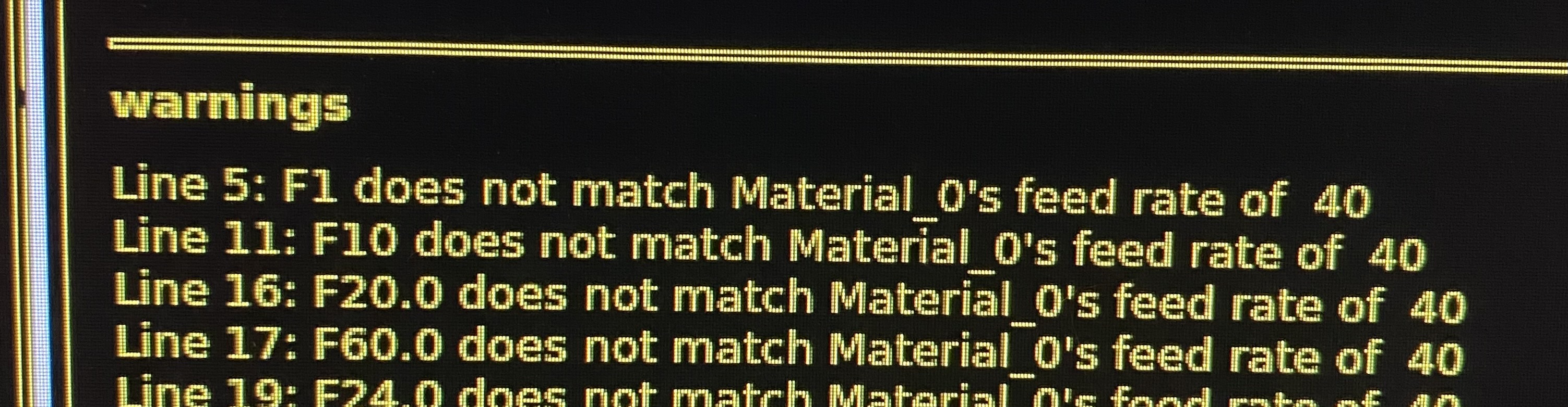

Sheetcam Linux post processor to QtplasmaC was created by Beaupre
Last edit: 29 Nov 2023 10:08 by Beaupre.
09 Dec 2023 10:46 #287633
Replied by andypugh on topic Sheetcam Linux post processor to QtplasmaC
The message are fairly clear. The question is which one do you want to win the argument?

I am in the same boat, I assume because my tools in Sheetcam don't match my tools in QTPlasmaC.
I have read the user guide and I think I understand there are a few options but I am really curious what is current consensus on how to do this because I have to have matching tools in each piece of software.
Is it preferred to maintain them in Sheetcam or QTPlasmaC?
It seems easier to work with them in Sheetcam.
- Posts: 12156
- Thank you received: 4149
19 Dec 2023 20:05 #288613
Replied by rodw on topic Sheetcam Linux post processor to QtplasmaC
There are some variables you can set in the post processor to change behaviour.
There is a script that takes a Sheetcam tool library and imports it into Plasmac.
If managing tools in Plasmac, all taht it uses from sheetcam is the tool number.
managing the tools in plasmac is more convenient because you can tweak things without having to reprocess the file in sheetcam,

Does the tool selected in QTplasmac take precedent over the selected sheetcam tool?
- phillc54
- Posts: 5711
- Thank you received: 2100
20 Dec 2023 03:17 #288637
by phillc54
Replied by phillc54 on topic Sheetcam Linux post processor to QtplasmaC
A tool change in gcode will take precedence.
