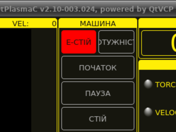

I tried to translate the interface but qtplasmac doesn't see my langfile. This is probably a problem with my system locale?

Can you post the language file, I will make a new virtual machine for testing. You may need to add .txt to end so the forum accepts it.

2 years 8 months ago - 2 years 8 months ago #293808
by Franklin
Replied by Franklin on topic Translation files for QtPlasmaC
I tried renaming it to qtplasmac_uk and nothing changed.
