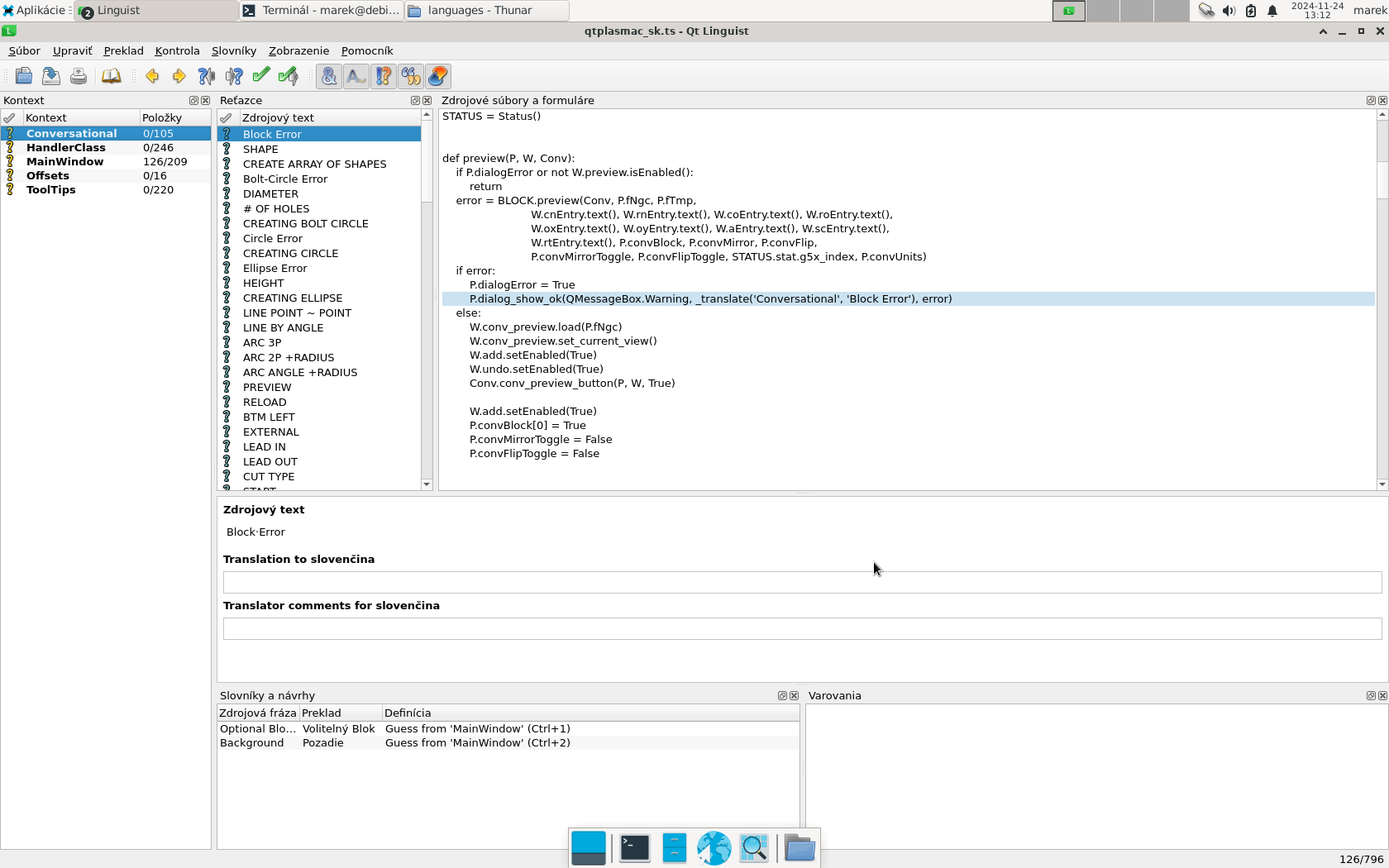

Hello,
I would like to create translation files for Slovak, but I have been unsuccessfull so far.
This is my progress so far:
- I have Installed linuxcnc from image
- deinstalled the linuxcnc and installed as run in place
- I have configuration running with mesa 7i96s
- i was able to generate QM and TS files, and create links to compiled .qm files
- i have tryied to copy qm files directly to /qtplasmac_4x3/languages/ /qtplasmac_9x16/languages/
- my version is QtPlasmaC v2.10-008.054
I have only edited the file in LINGUIST, do I need to do this step from howto?
Is there any obvious problem with my workflow?
thank you for help.

What is the file that you attached, there doesn't seem to be any translations in it.
Can you post the .qm and .ts files as a zip file.
Replied by phillc54 on topic Translation files for QtPlasmaC
No, you only need to do that if there are any changes to the original English version so the changes can be added to the translation.I have only edited the file in LINGUIST, do I need to do this step from howto?
If any text changes are made to the GUI then run the following to create a GUI python file: $ pyuic5 ../qtplasmac.ui > qtplasmac.py

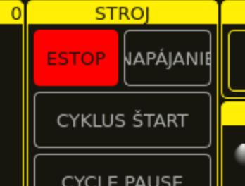

I have translated mainly the MainWindow when I decided to test it, before putting more hours in it.
I have also tested to translate only one button "estop", the compiled .qm file had the translation inside.
I have also spotted difference between mine and @Franklin's .ts file. At the very beginning, the line="42" and line="43" is different. Does this means that these translations arent compatible between versions?

<?xml version="1.0" encoding="utf-8"?>
<!DOCTYPE TS>
<TS version="2.1" language="uk_UA" sourcelanguage="en">
<context>
<name>Conversational</name>
<message>
<location filename="../../../../../lib/python/qtvcp/lib/qtplasmac/conv_block.py" line="42"/>
<source>Block Error</source>
<translation type="unfinished"></translation>
</message>
[code]<?xml version="1.0" encoding="utf-8"?>
<!DOCTYPE TS>
<TS version="2.1" language="sk_SK" sourcelanguage="en">
<context>
<message>
<location filename="../../../../../lib/python/qtvcp/lib/qtplasmac/conv_block.py" line="43"/>
</message>

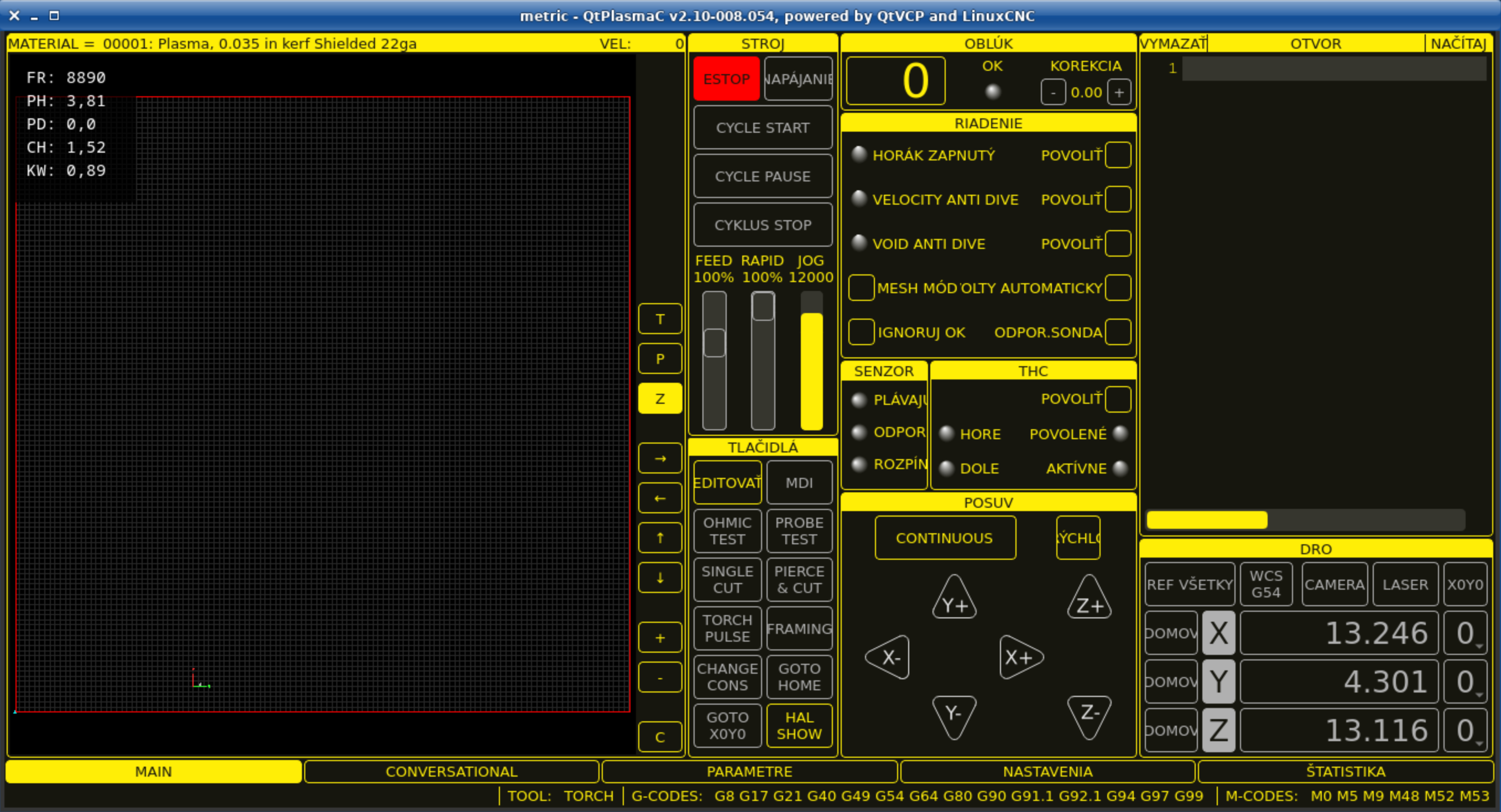

It looks like bad instructions on our part...
Try renaming qtplasmac_sk.qm in linuxcnc-dev/share/qtvcp/screens/qtplasmac_4x3/languages/ to qtplasmac_4x3_sk.qm
If that works for you then we will edit the documentation.

It is working now! Thank you for your support.It looks like bad instructions on our part...
