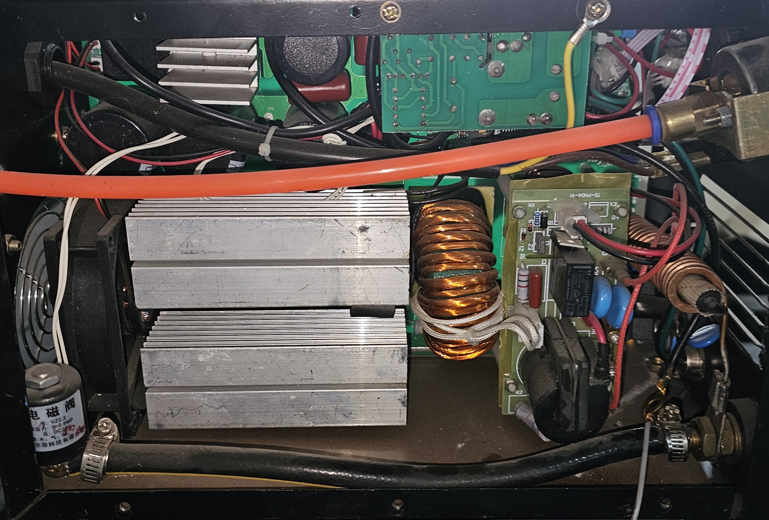

This is the cut50 inside.

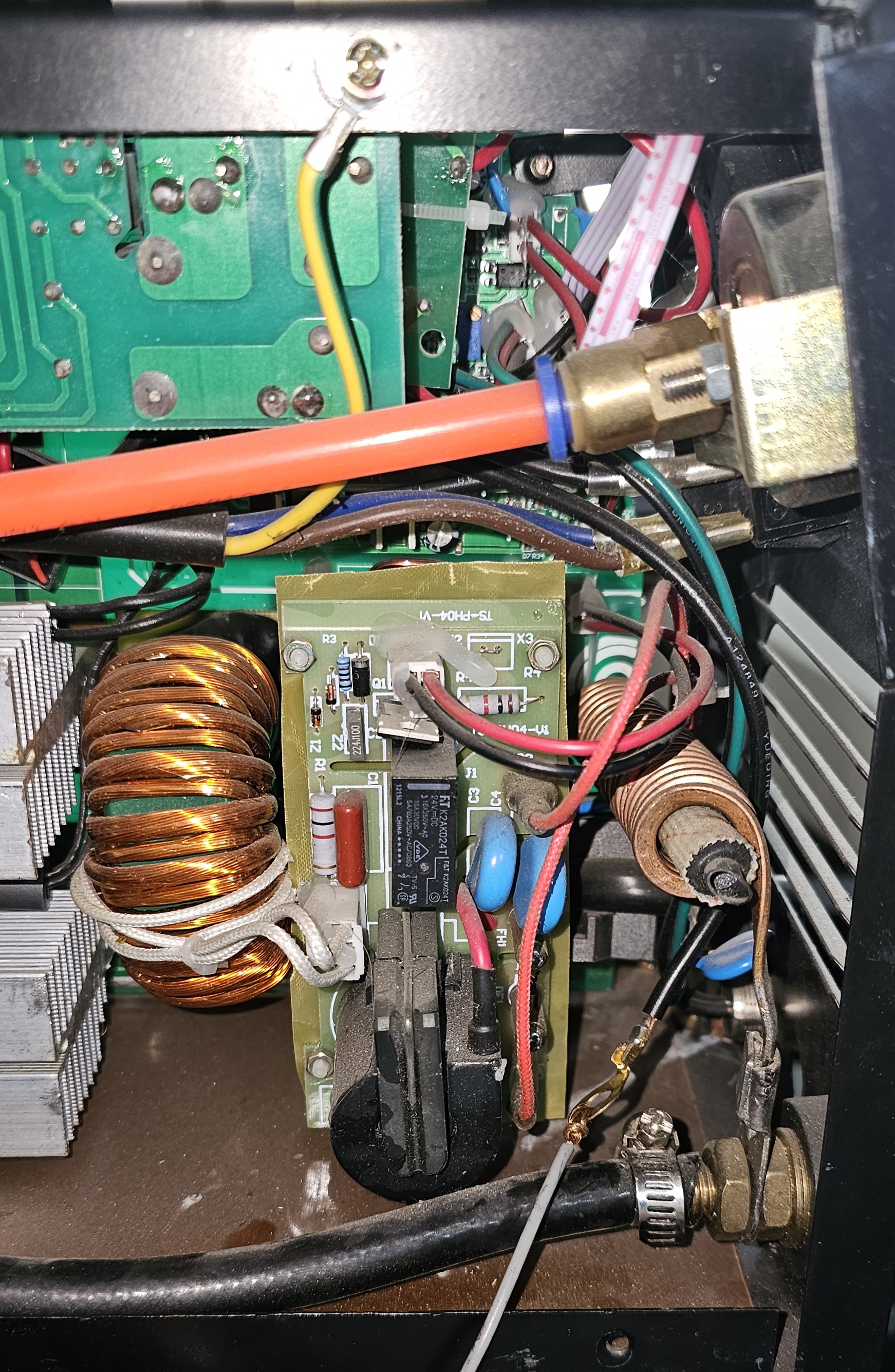

- Posts: 18109
- Thank you received: 5329
25 Mar 2024 14:31 - 25 Mar 2024 14:32 #296720
Replied by PCW on topic Cut50 Wiring
The HF transformer secondary is the long flat wire coil in series with the torch connection.
The plasma voltage must be taken from the non-torch end of that coil. That point should
connect to a 2 or 3 MOhm 1W resistor insulated with heat shrink (inside the CUT50 box)
and kept as far as possible from the torch end of the HF transformer and then to the negative
THCAD input. The positive THCAD input should connect to the Table or work connection inside the
CUT50 BOX.
The two wires going to the THCAD inputs should be a twisted pair or coax
(if coax, the positive lead should be the shield)
NOTE: there are voltages present in a plasma source source that can electrocute you even
after power is turned off/disconnected. Beware that both the output and primary side capacitors
may retain a a lethal charge for a long time.
Also note that this is a HF start plasma source and will require very careful shielding/grounding
of the motion/control components to avoid erratic behavior or even damage to the control
electronics from torch starts.
CUT50 BOX.
