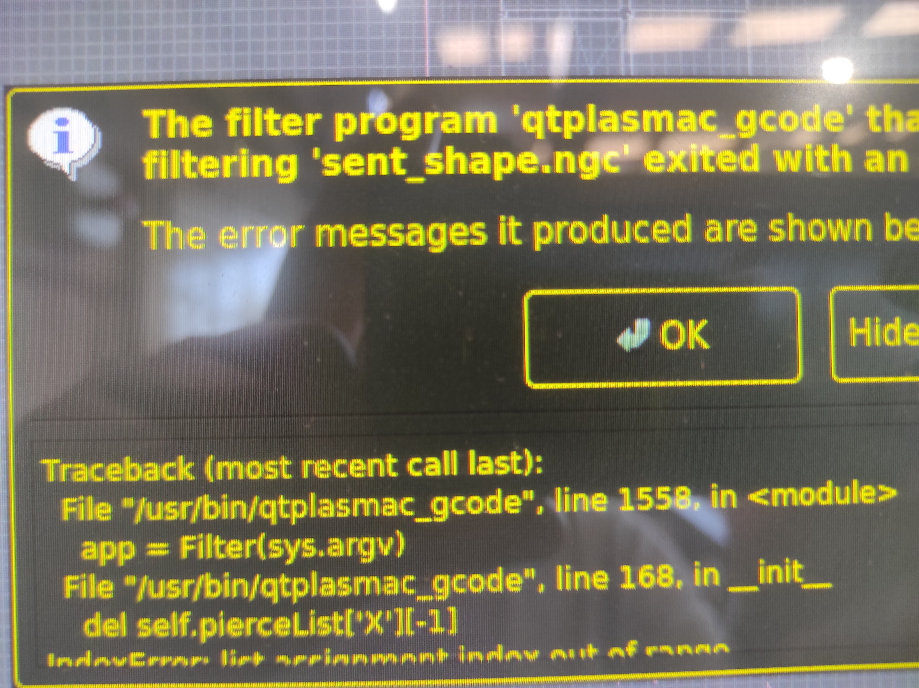

It would be helpful to know what version you are currently on.
It would also be helpful if you could be more descriptive about what you were trying to array? Help us understand the steps you were going through when you encountered the error.
I did make a 4" x 4" rectangle at 0,0 origin, and then array it in a 2 row by 2 column array with both offset by 6". It sent fine and didnt give any errors.
There was a small window when there was an error with the gcode filter and the code in question, which makes me wonder if you are not on the latest version...

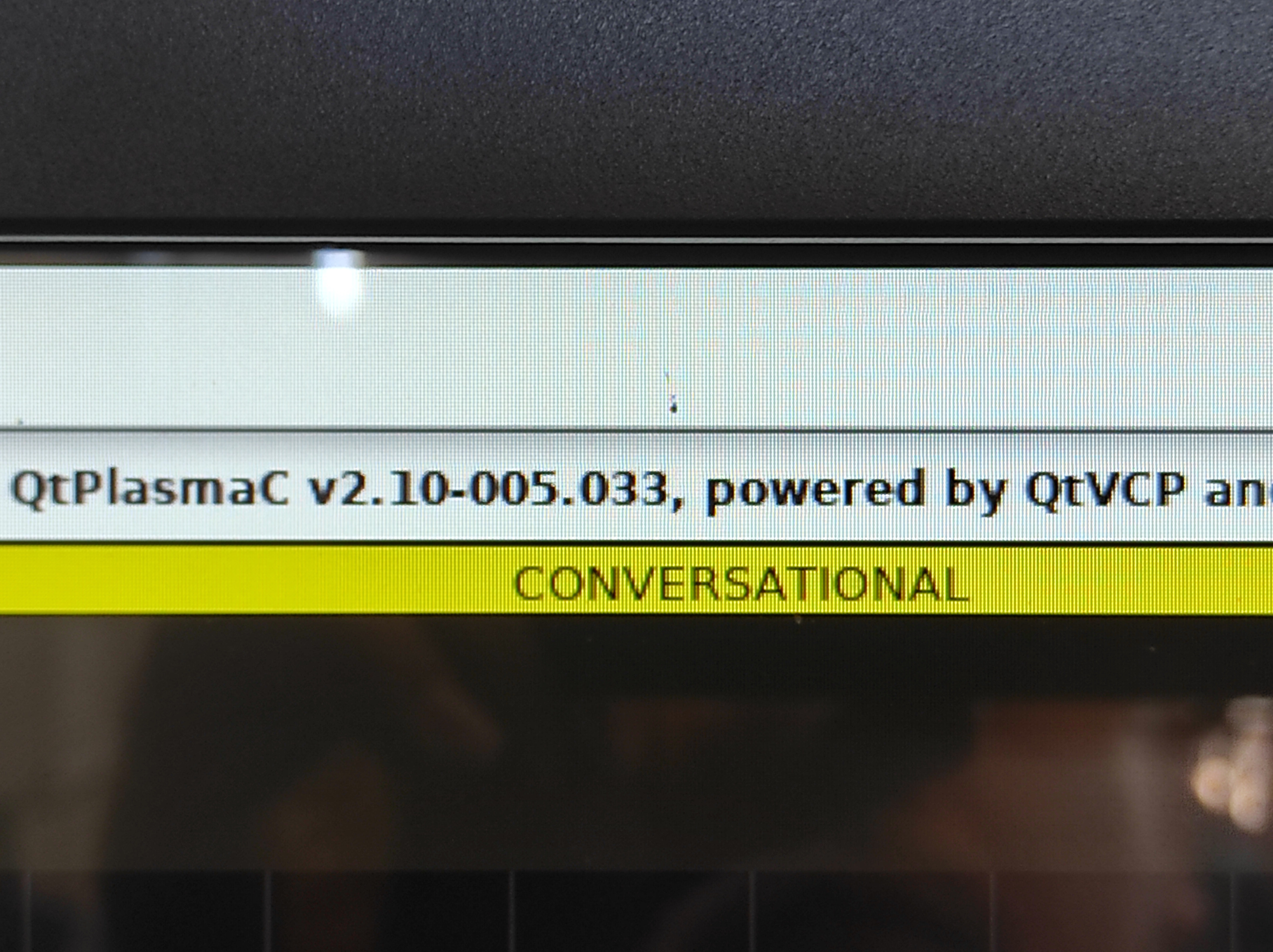

Thanks for your response, attached are the configuration files and the part causing the error.
the QTPlasmaC version is v2.10-005.033

Replied by phillc54 on topic error on array funtion
I can see this issue, we should be able to have a fix soon.

by phillc54
A fix has been pushed for this. Sorry about the delay, we got a bit sidetracked...
