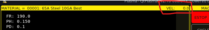

on the qtplasmac screen I'm sure there is a way to add or see the travel speed while cutting. But is there one already there that im just overlooking?
Circled in red below:

Just opened qtplasmac and looky there I see it now. lol... I figured I was just overlooking it. was curious because the dry run I did seemed awfully slow since it was set to 200IPM unless qtplasmac uses the default material settings instead of presets in the g-code?
