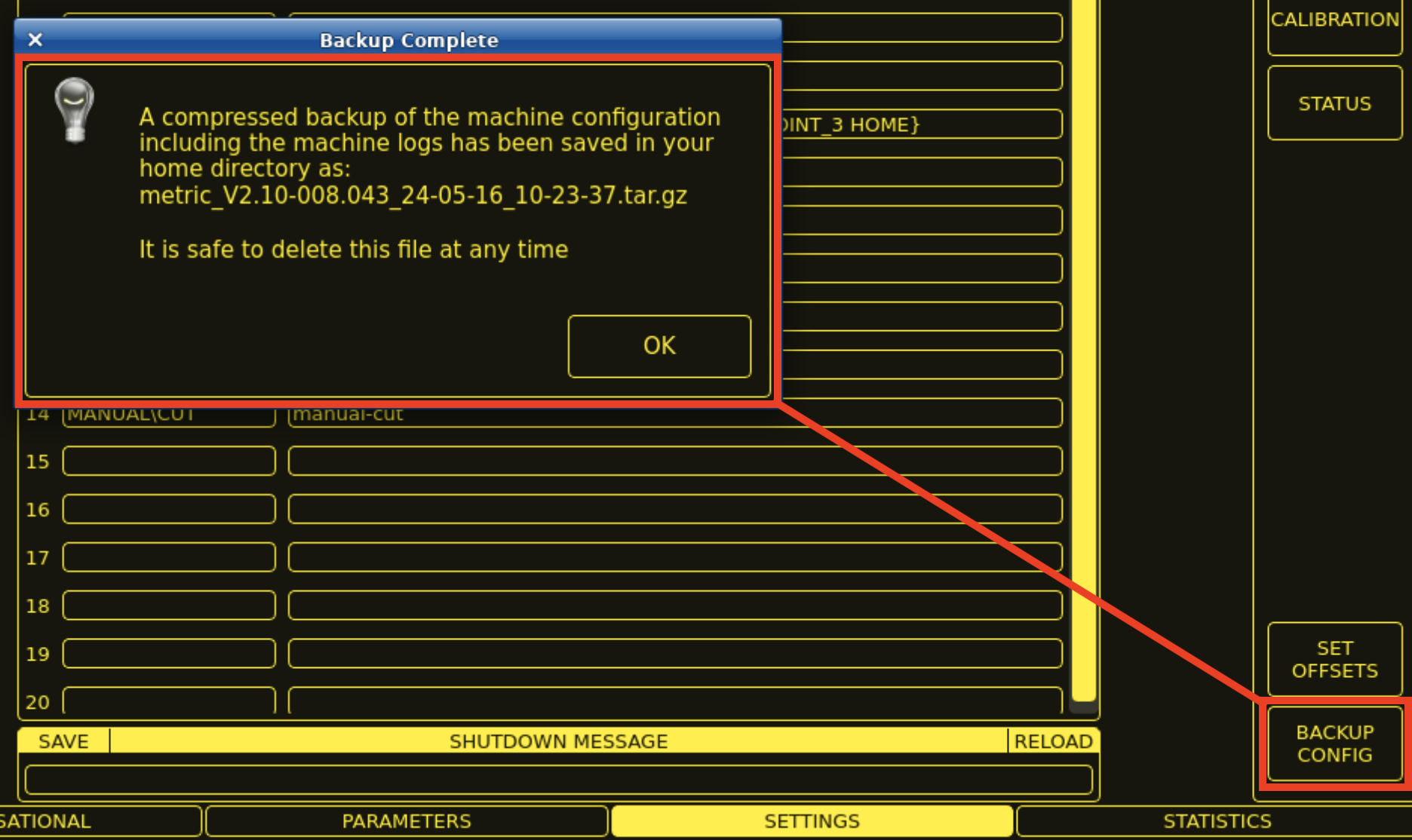

HI

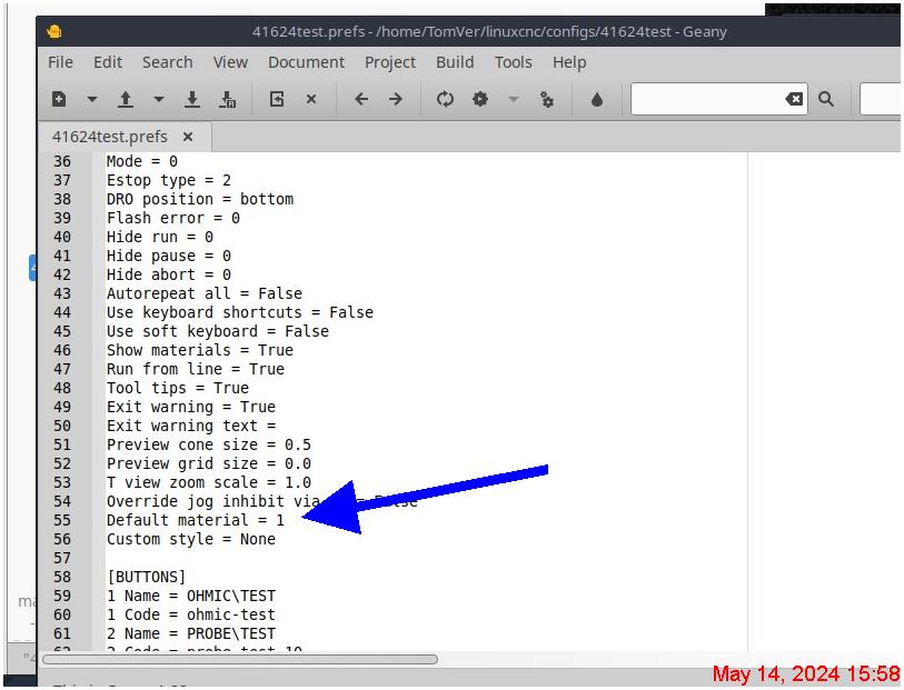

I am getting the "invalid material number" again, last time you said make sure Default material =1 and it is.

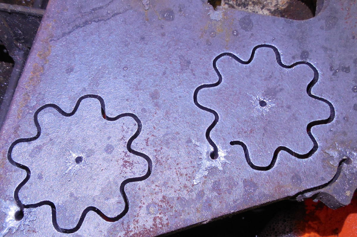

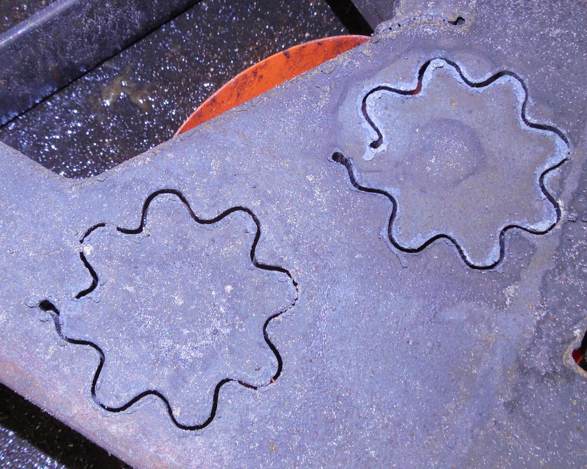

Next for some reason there is a problem at the end of a cut, the torch seems to be at a good height until just before the end and it dives. These images show it both top and bottom shown.

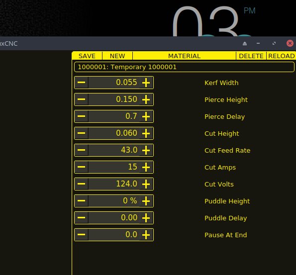

Next the material info seems to be reset to 10000001: temporary 10000001 after it cuts. Before the cut I set it to one from the list.
one other question is should I run the Latency test before I do anything at the start?? I am running version V2.10-005-033
Thanks for your time
Tom
Tom

Can you post the g-code file for the above cut and also the BACKUP from the SETTINGS tab.

No expert on G-codes but cannot see any reason for the cut to end as it does. It does not give an error just acts like it is finished.

16 May 2024 00:30 #300709

I did click on that but could not find where it was stored to copy and send.
Sorry I will try again, here are 2 other files from that date are either the one you are looking for??
config_info.txt
config_info.txt

Thanks, the one I am looking for is 41624test_V2.10-005.033_24-05-15_08-30-08.tar.gz

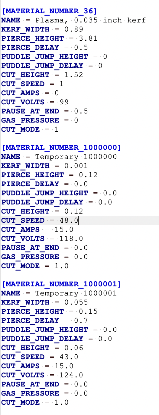

The reason that you are getting the "invalid material number" warning is because you have materials #1000000 and #1000001 in your materials file (41624test_material.cfg). They both need to be deleted.
I cannot find an obvious (to me) reason for the THC issue that you are having.
It is probably worth trying a cut with the VAD Threshold set to 905 rather than the current 64%.
If that doesn't help then try a cut after checking the Auto Activate checkbox.

What is the THC delay set to?
Seems like being quite long so THC is not active till near the end where it activates and plunges.
