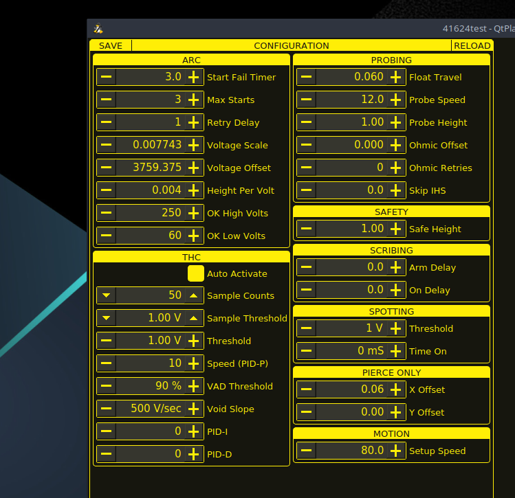

Tommy I looked for the delay in the THC and it was set to 1.5 I changed it to .2 now if you do not have "Auto Active" on it will show.  But not if "Auto Active" is on see screen shots.

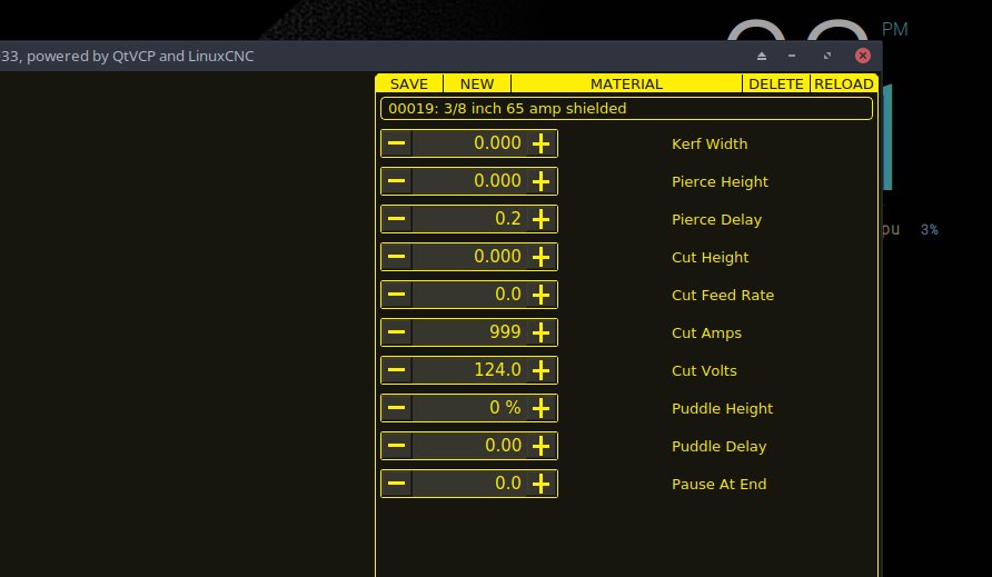

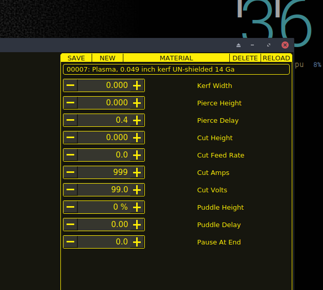

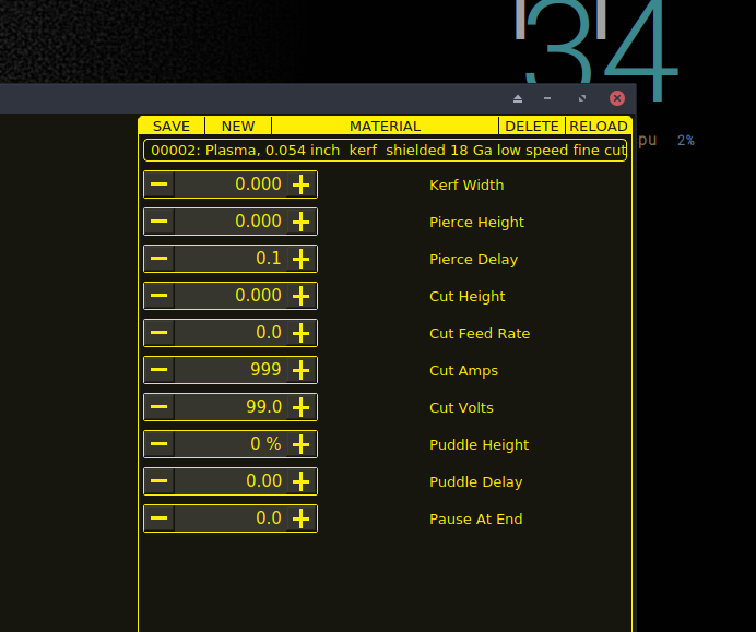

Something else I found after running QTOlasmaC-Material to convert SheetCam tool list to be used in QTPlasmaC none of the needed entries are converted it just shows 000 (Pierce height, Cut height, cut volts, and feed rate) see below.  If you look at the list the metric info is there but no the English values as shown below????  Even though I use English in SheetCam the tool list is recorded in Metric, the conversion software gives the option to convert either using a check box.  Maybe I needed to use the Metric conversion not the English.
I have since manually added the needed info to the material list.  I have video showing another thing with the material list uploaded to the Google Drive, when it clears I will send a link to you.

I think that you would need a very good quality plasma power supply to use 0.2 second THC Delay, I found with my Hypertherm that 0.5 was the minimum safe value I could consistently use.
If THC Auto Activate is checked then THC Delay is not used, it uses Sample Counts and Sample Threshold. For example, if Sample Counts = 50 and Sample Threshold = 1.00 V it would require 50 consecutive cycles of the arc voltage being with 1 volt of the materials Cut Volts after the Cut Feed Rate was reached.

Replied by phillc54 on topic New set of problems
Your video about the materials is showing the correct behaviour.
Material numbers 1000000 and above are reserved for temporary materials, these are created by the post processor if required in the g-code file.
If your g-code file has something along the lines of:
 (o=0,kw=0.054, ph=0.12, pd=0, ch=0.12, fr=43, th=1, cv=124, pe=0, jh=0, jd=0)
then a temporary material will be created when the g-code file is loaded and it will appear in the material list on screen but will not be added to the material file on disk.
If you then load a g-code file that does not have any temporary material then there will be no temporary material in the material list on screen.
Could you post your SheetCam tool list.
