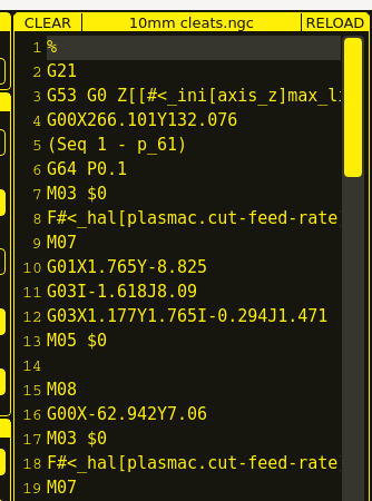

Hi guys, I want to make QTplasmac's custom filter insert a G91 in front of the G64 command but I get an error. This is what I have now to override the method
Can somebody help me straight please?
The actual reason for this is that the files from the nesting program is programmed in G91 but where QTP inserts the G53 command to move to the top of the Z axis, it is not permitted in G91 incremental mode. So I want to replace the G91 with G90 and then put the G91 back after you have made that change. Open to other methods.
Gcode example and filter attached.I have been able to replace the M07 and M08 with M3/M5 and insert the plasmac feedrate. I am also not sure why the M07 and M08 are still there.

As for why the 'M07' and 'M08' are still there:
Note how your code will attach the original string (ie 'M07' and 'M08') stored in the variable 'data' to the return string, so try this:
As for the other problem, what is the error you are getting?[/code][/code]

- phillc54
- Posts: 5711
- Thank you received: 2100
09 Jul 2024 00:15 #304714
by phillc54
Replied by phillc54 on topic Override set_default_blending
@rodw Is this working OK for you?

09 Jul 2024 03:59 - 09 Jul 2024 04:00 #304722
by phillc54
I think that all you need in the custom filter is:
def custom_pre_parse(data):
if data[:3] == 'M07':
return(f'\nF#<_hal[plasmac.cut-feed-rate]>\nM3 $0')
if data[:3] == 'M08':
return(f'M5 $0\n')
return(data)
self.custom_pre_parse = custom_pre_parse
def custom_post_parse(data):
if data[:3] == 'M30':
return(f'G90\n{data}')
return(data)
self.custom_post_parse = custom_post_parse
