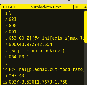

I don't think that works. the G53 command requires G90 to be active and the G53 is issued before the cut starts with an M3
G91 needs to be active before any cutting motion starts.
So the sequence needs to be:
G90
G53
G91
M3
(cut)
M5
M30
Setting something at the end of the file won't achieve what we want as the G91 is not active when the next M3 is encountered.
Maybe I am not understanding something.
G90
G53
G91
M3
(cut)
M5
M30

If a cut is terminated early (eg estop) won't it be left in G91 so the next run will fail?
- phillc54
- Posts: 5711
- Thank you received: 2100
09 Jul 2024 05:09 #304726
by phillc54
Replied by phillc54 on topic Override set_default_blending
True that. Probably should force a G90 early on...If a cut is terminated early (eg estop) won't it be left in G91 so the next run will fail?
- phillc54
- Posts: 5711
09 Jul 2024 05:20 - 09 Jul 2024 05:21 #304727
by phillc54
This should be all you need:
Warning: Spoiler!
def custom_pre_parse(data):
if data[:3] in ['G20', 'G21']:
return(f'{data}\nG90')
elif data[:3] == 'M07':
return(f'\nF#<_hal[plasmac.cut-feed-rate]>\nM3 $0')
elif data[:3] == 'M08':
return(f'M5 $0\n')
elif data[:3] == 'M30':
return(f'G90\n{data}')
return(data)
self.custom_pre_parse = custom_pre_parse
[/spoiler]

As luck would have it now we get to running this on a real machine (and a sim) it fails.
It seems the G91 is being inserted too early. It should be inserted after the G53 so an error is not generated
I've attached the filter we worked out earlier and a new gcode file.
Any help to fix this would be appreciated.

It is looking a bit ugly but it seems to do what you need:
Warning: Spoiler!
# for custom parsing before standard parsing
# Suits Hypertherm Nestmaster
incSet = False
global incSet
return(f'M5 $0\n')
elif data[:3] == 'G00' and not incSet:
incSet = True
return(f'G91\n{data}')
elif data[:3] == 'G91':
return None
return(data)

Thanks Phill, It seems to be working again. Hopefully it keeps working!
This complete config can be found here for those interested. github.com/rodw-au/showstopper
