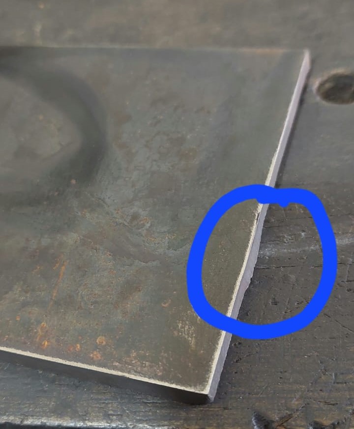

Thank you very much for your help, replace the torch head and it works normally, I have a question, why does the arc deviate? I am cutting some squares and the arc deviates a few centimeters after starting the cut, the consumables are new.

Replied by tommylight on topic Inssues Arc Start
Most probably from a kink in the air hose to the torch.
Is it always in the same place on the table?

If I place the start cut on the ·x axis, the deviation appears a few cm from beginning the cut, and if I change the perforation to the axis "y " and the deviation goes to the y axis, it is always a few cm from the perforation.
