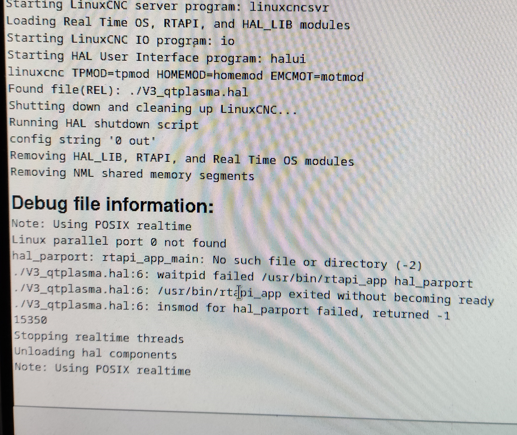

Hello,I can no longer launch Qtplasma, I have the following error message, thank you in advance for your help

Looks like a hardware error.
Do you have a motherboard parallel port or is it a a plug-in card?

I have a PCI card, I don't understand because before it worked perfectly

You might try re-seating the Parallel port card, though it may have failed.

I no longer have an installation CD
