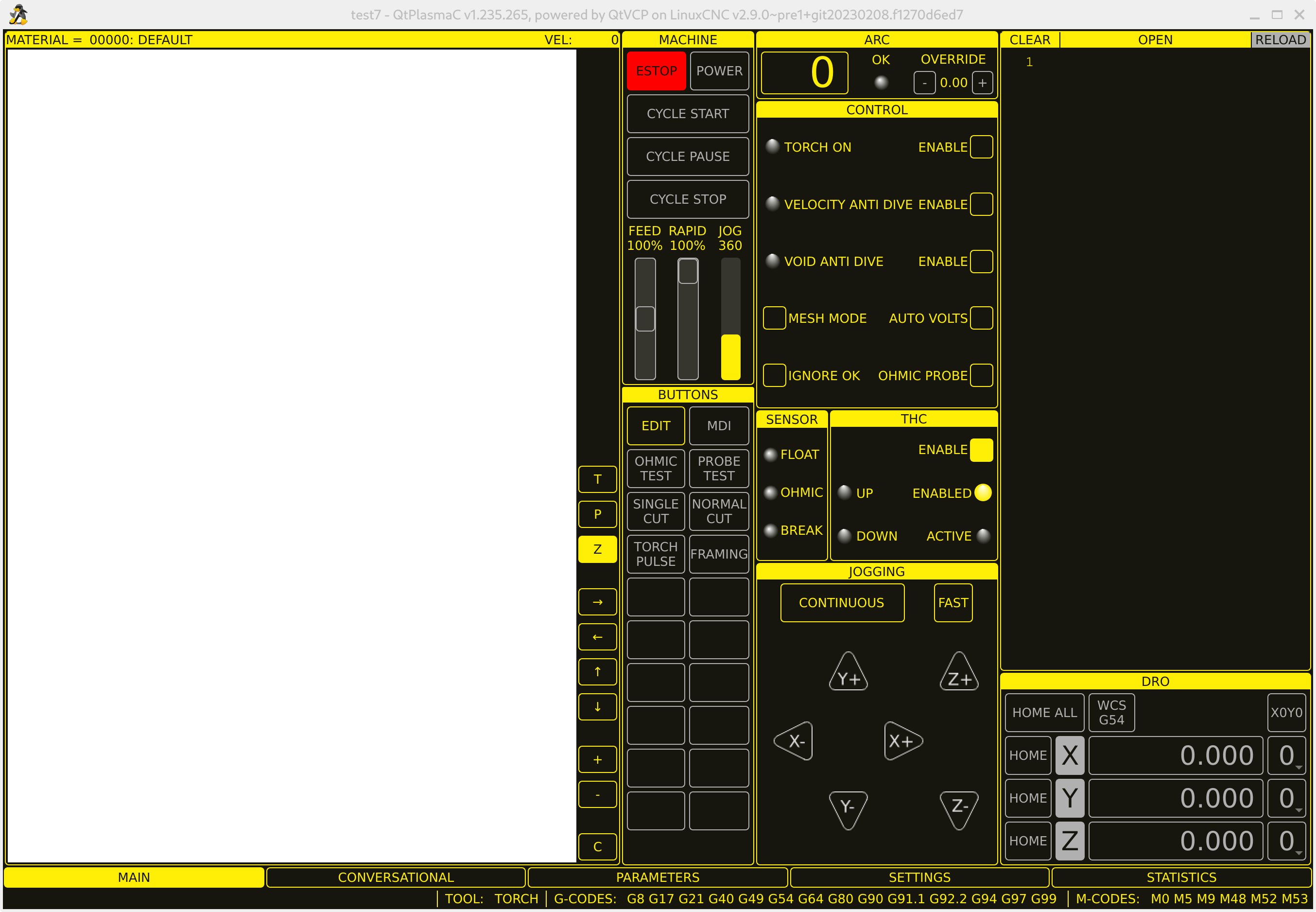

Hey All,
So new CNC built and i'm trying to connect to it. and thats fine, however I cant get linuxcnc to do anything once open, the estop is stuck on.

Moved this to PlasmaC section and had to change the tittle as it is not LinuxCNC issue, but it surely still is an QtPlasmaC issue, apparently.
I am sure i have mentioned this a year or two back, but i can not find it here or on the NAS as to what i changed for it to work. Will try again later, hopefully.
Personally, the e-stop behavior should have not been changed, ever, and no latches.

It'd be much easier to help you if we had a back up of your config created from the GUI.
linuxcnc.org/docs/devel/html/plasma/qtplasmac.html#_support
That said, by default in QtPlasmaC, the estop shown on the GUI is an indicator only.
Setting Estop type = 0 in the [GUI_OPTIONS] section of the <machine_name>.prefs file, will change this button to an indicator of the hardware E-stop’s status only. This is the default behavior.

IIRC, when choosing normal button for e-stop, it does not add a line in hal for it.

It’s impossible to know what’s going on without looking at his config.
I think some of the confusion with GUI estop buttons and QtPlasmaC comes from the fact that every time estops come up with regard to plasma a certain forum user shares his infinite wisdom and Hal logic and completely muddies the waters.

RNJFAB, can you try editing the config and choosing something else for e-stop? There are 3 types.
And what type did you choose on this config?
The PC that had the config is gone, it was with the 2.9 version from the Debian repositories.
I think the 2.10 does not have this issue, i think i made a new QtPlasmaC config on a Lenovo laptop that just worked. OK i just checked this, it is an existing PlasmaC config converted to Qt and it worked properly.
The following user(s) said Thank You: RNJFAB

Thanks Guys,
Changed settings to reflect e-stop as a button and i'm able to select it now.
Still have a blank or other shadow in the box where you would normally see what you have loaded. Not sure why.
An now that everything has been double and triple checked, i can't form any connection to the motors.
