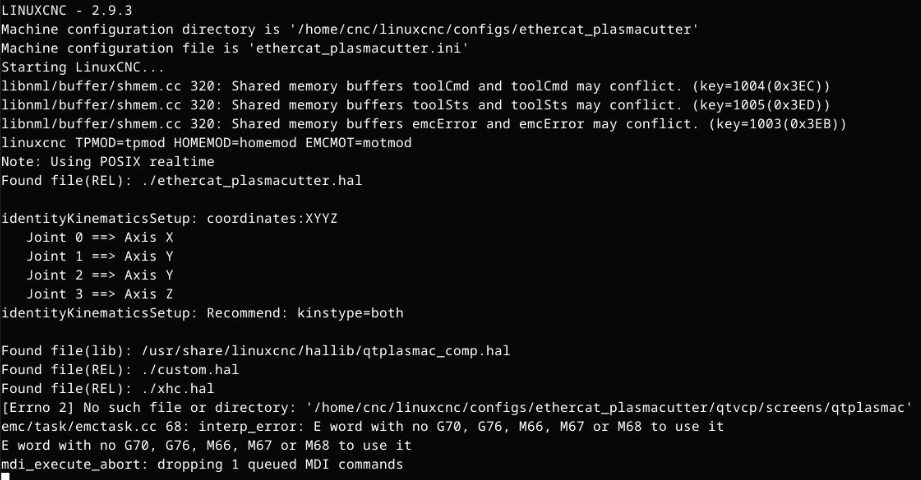

Hello everyone
I recently installed a laser on my plasma cutter to mark the origin. When I try to mark the origin of a part, I am getting the error message "E word with no G70,G76,M66,M67 or M68 to use it". Failure happens during this procedure:
1) Press "Laser" button in the DRO window
2) Move to position
3) Press "Mark Edge" button
4) Make a second move to desired origin (so it considers rotation)
5) Press "Mark Origin" button
6) --> Error: "E word with no G70,G76,M66,M67 or M68 to use it"
It happens like 50% of the time doing this procedure. I am using QtPlasmaC with LCNC 2.9.3.
Anybody experiencing the same or having a hint as to why this occurs?
Thank you!

09 Feb 2025 19:20 #321101
Replied by andypugh on topic QtPlasmaC Error: "E word with no G70,G76,M66,M67 or M68 to use it"
This suggests that something (like a remap) is calling a bit of G-code with the letter E in it.
Or possibly there is something in your actual G-code file that is making it see an E as a command?

23 Feb 2025 16:31 #322376
by Sandro
Replied by Sandro on topic QtPlasmaC Error: "E word with no G70,G76,M66,M67 or M68 to use it"
Sorry for my late reply.
I have tested today without any G-Code loaded. The issue remains.
As far as I am aware, I am not calling any special subroutine. Just the default feature from QtPlasmac.
What I've noticed is, that I am using the HAL-Pin plasmac:laser-on instead of qtplasmac.laser_on from the QtPlasmac users guide. I was simply unable to get it to work with qtplasmac.laser_on.

07 Jul 2025 18:57 #331477
by Sandro
I was never able to figure it out. Especially since it only happens sometimes. Now I am just using a simple button in QtPlasmaC which works fine for my needs:
9 Name = LASER\OFFSET
9 Code = G10 L20 P1 X0 Y0 \ G54 G0 X17.0 Y151.8 \ G10 L20 P1 X0 Y0
