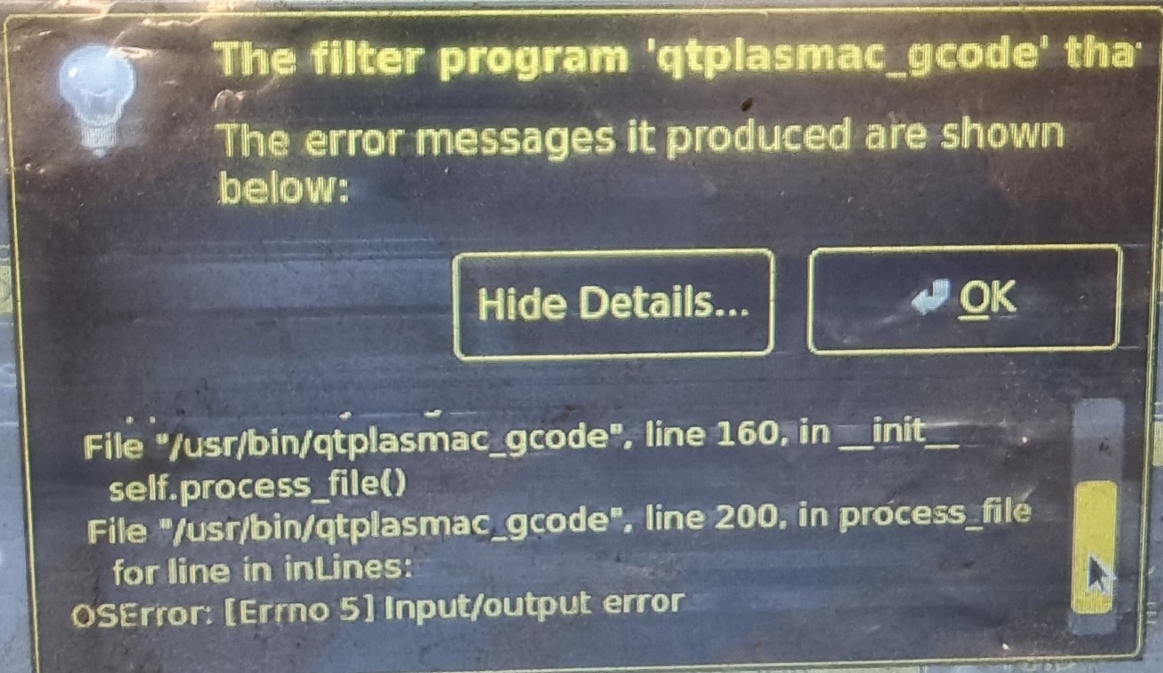

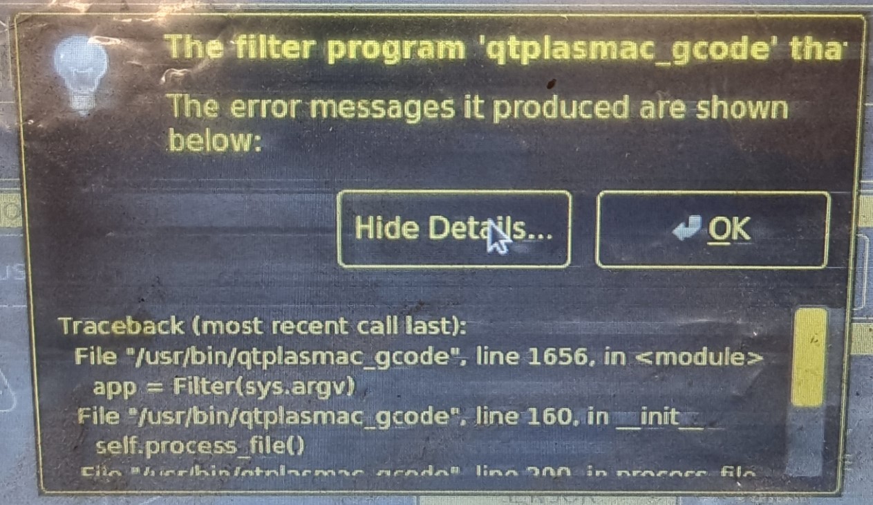

After not using my table for a couple of weeks, I am getting this error when opening a file. after seeing this I took the opportunity to upgrade to latest version hoping it might sort it but it is still exactly the same. It was working fine last time I used it. Any thoughts?The filter program 'qtplasmac.gcode' that was filtering ***.ngc exited with an error.

Replied by tommylight on topic Filter program 'qtplasmac.gcode' exited with error
Input/output error is usually failing hard drive or inability to read/write to it.

by Howlingg
Replied by Howlingg on topic Filter program 'qtplasmac.gcode' exited with error
Many thanks for the quick reply and solution, it seems to work fine if I load a file from a usb stick so there must be an issue with my network drive. Thanks again!
