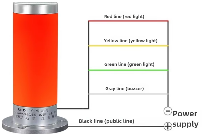

02 Mar 2025 12:08 #323036
by grijalvap
Safety Light was created by grijalvap
- Posts: 12176
- Thank you received: 4155
02 Mar 2025 14:08 #323044
Replied by rodw on topic Safety Light
The attached is old hal code that Todd helped me with which uses, red, orange and green lights. The green light flashed (via siggen) when a program was paused. red was from the estop
The Run/Step/Pause/Resume part is described in hal examples on the forum but it won't work with QTplasmac which has its own pins that achieve a similar result.
Her is and example of it running. I did eventually wire this into some stack lights like you show,
