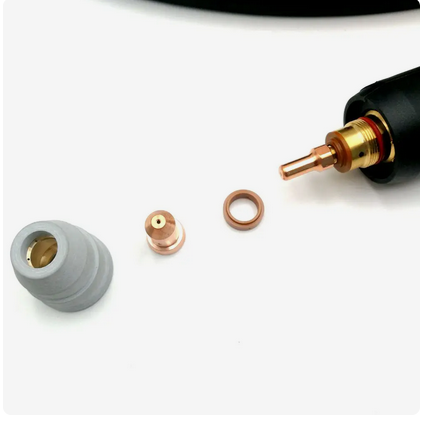

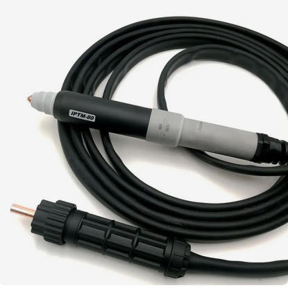

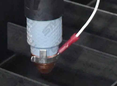

Hi all
i bought a cheap plasma Herocut Cut55i and i have machine plasma torch IPTM-80 like this
i try to do ohmic Hypersensing with a MESA THCAD-10 on my cnc table
Can you explain how physicali connect ohmic sensor?
Can i do ohmic ring something like that to the copper shield
or it is impossible on this type of torch and all that remains is floating switch?
thank you

Here is how I did it.
forum.linuxcnc.org/show-your-stuff/56269...sensing-with-iptm-60
TLDR; Disconnect the ground lead in the plasma torch cable. Measure voltage between material ground and torch tip.

01 Nov 2025 07:33 #337618
by Hakan
Replied by Hakan on topic Machine plasma torch IPTM-80 and ohmic sensor
Yeah the thread is long and full of failed attempts and iterations.
That's my development cycle, sadly.
The last post summarizes it. And this post show the performance forum.linuxcnc.org/show-your-stuff/56269...m-60?start=20#336805 It keeps performing like that even on water and rusty pieces.
Because the torch is the way it is, the ground leads in the torch, used during the arc start, needs to be cut and a small voltage applied which one measure to detect contact with the material. The rest is implementation and packaging in a nice format.
If you are willing to do surgery on the long cable to the torch you can cut it open and access the ground leads in there.
Instead, I made a short extension cable where all modifications were done.
I also used two separate voltage readers but I don't think that is necessary.
One uses the built-in voltage port, one measures directly between material ground and torch tip.
I will cut some parts later today so I can compare the voltage output of the two.
Of course, Mesa's THCAD cards can be used, the full voltage version.
