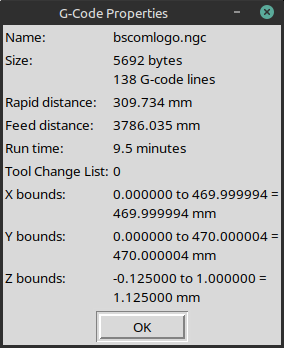

Is there an easy way to estimate a programs run time? I tried searching and couldn't find anything.

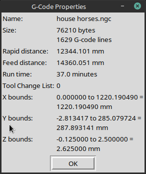

Axis GUI, included with LinuxCNC has such a feature in "File>G code properties" menu:
It is fairly useful when you know what it actually shows, like the actual feed time, nothing else, so no G0 moves, no probing, no compensation for feed rate changes, etc.
Takes a bit of time to get used to it, so for simple stuff with not much pierces i just double that time, for more complicated stuff like 286 cuts on a plate i just wing it to 4 or more times the shown time. Works fine for rough estimates.
