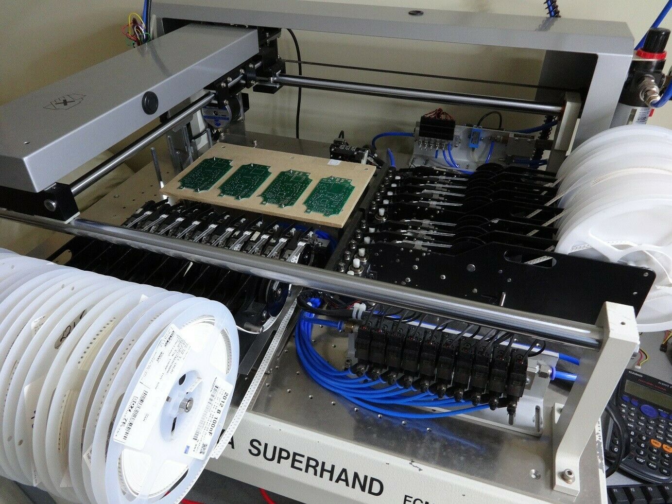

Mine was made by Mamiya. It has 5-phase stepper motors.
Unlike the one in the video it has one cylinder for each feeder, for a total of 20 cylinders.

Yours will be able to cycle faster because it won't have to wait for a rack to get into position. Does it have a down looking camera
for faducial alignment?

Yes, there is a down-looking camera. I intend to swap it for a USB one to tidy up the wiring, and to add an up-looking one, probably. Though I need to check focal lengths and such for that.

Nice. As I understand OpenCV can be integrated in so linuxcnc can automatically align everything.
However for just getting the machine up and running just hook the downlooking camera to the computer and use
VLC media player to see where the camera is looking . You could then use the camera as an X Y offset for faducials.
That's the theory anyway.
