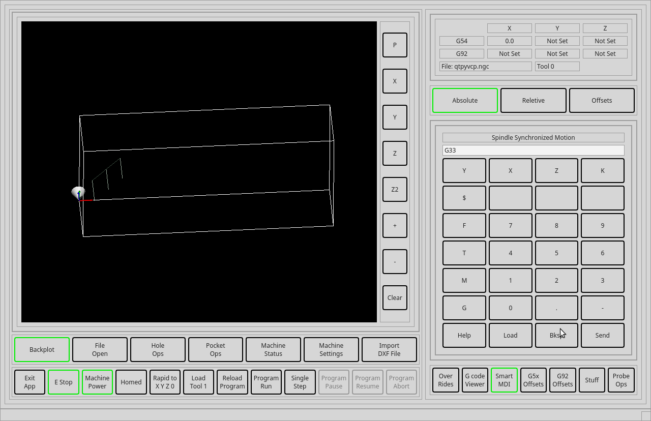

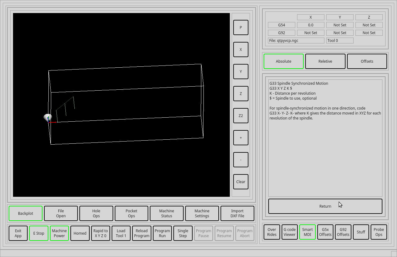

I'm starting to sort out what layout I want on the touch screen as well as adding conversational control and the Smart MDI. Here are some screenshots.
This is the main screens, there are three sets of stacked widgets, the upper right is the DRO and Offsets status, the lower right is all the stuff you might need and want to see the backplot and the left side is the main set of stacked widgets.

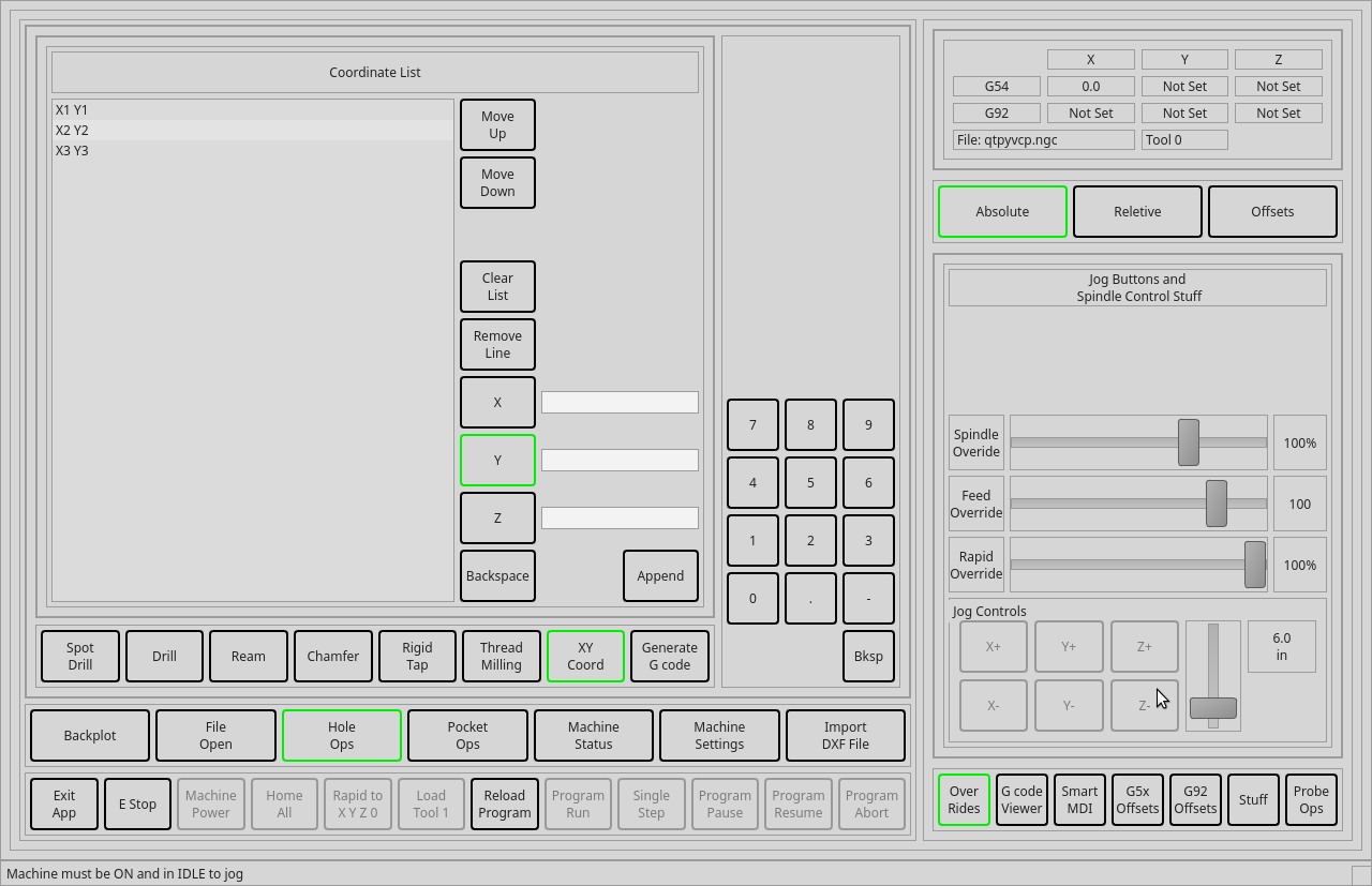

This is the conversational set entering drill parameters.
This is the conversational set entering in XY positions for each hole

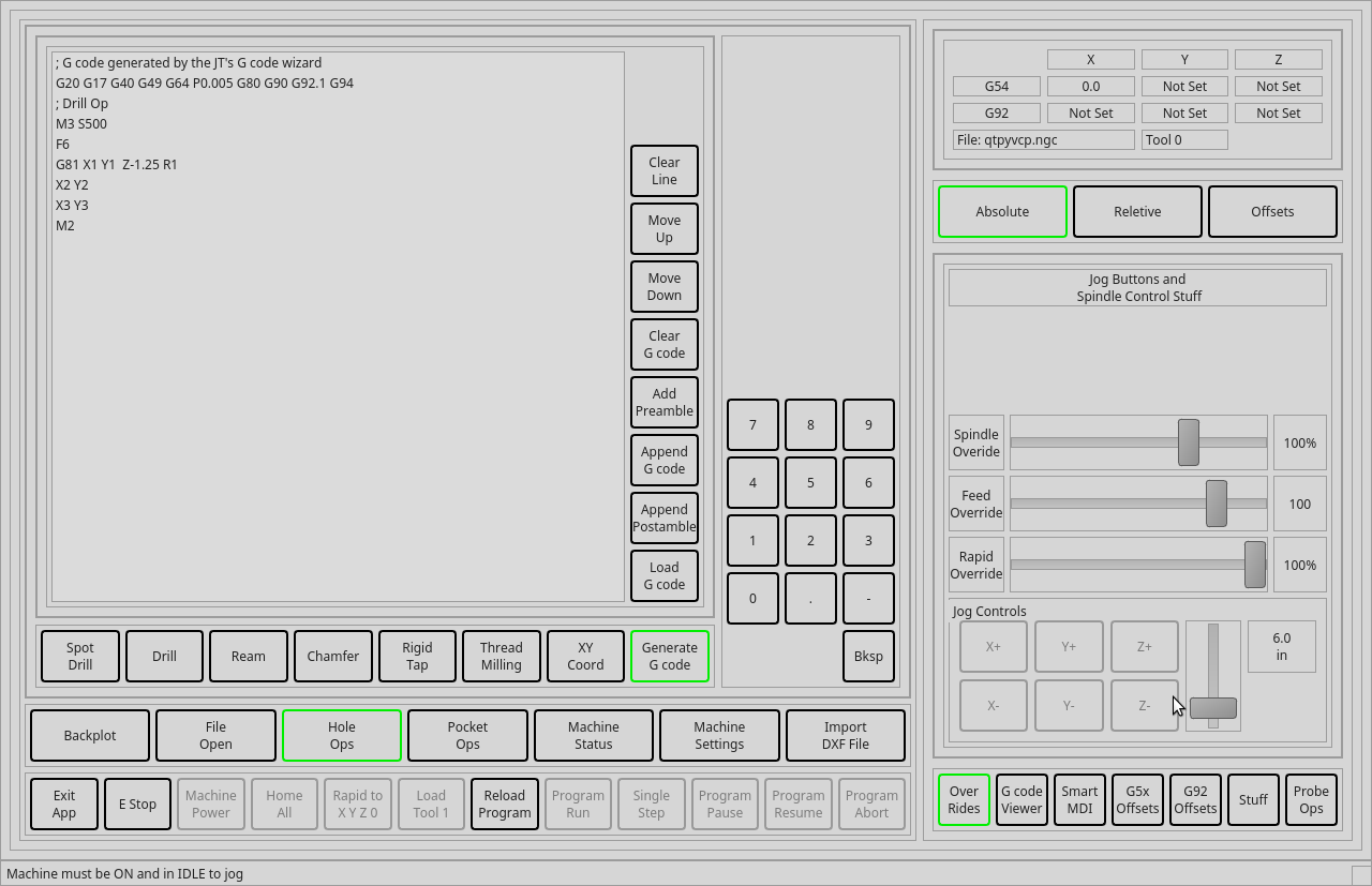

This is the conversational set creating the G code. You also have editing controls for the G code.

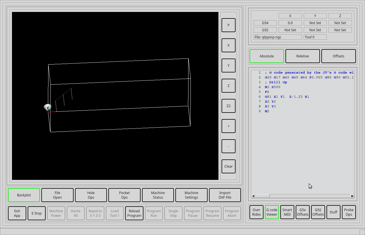

This shows the generated G code in the backplot and the G code Viewer.
This shows the Smart MDI screen, you enter in say G33 and press Load and the name of the G code is shown and the upper buttons are populated with the appropriate words for that G code.
This last shot shows the help screen for that G code.

Looks awesome, I like the spindle,feed and rapid over ride sliders. Do you have "distance to go" displayed somewhere as well? That and the feed hold I find to be one of the most used features of a control.
You've done a lot of cool work I wish industrial controllers had, great work!

Of course, I don't have any docs yet but you can clone and install with pip to follow along and test it.
github.com/jethornton/mill_touch_v4
JT
Replied by BigJohnT on topic QtPyVCP Mill Touch V4
Excellent John! Will you be sharing this on your GitHub?
Scott
git clone https://github.com/jethornton/mill_touch_v4.git
cd mill_touch_v4
pip install -e .
to update just do
git pullJT

Just a short video showing my Smart MDI Entry.
Looks best on youtube
JT

Brilliant, saves a lot of time not having to open quick reference !
Thank you.

Here is a video of some of the Hole Ops conversational stuff. Kinda cool you can copy from the MDI to the G code window so any possible G code can be added at any time.
And it looks better in putube lol
JT
