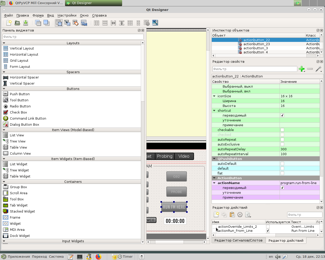

Hello! Tell me in detail how to add the run from line function to this interface? Thank you for your work.
- hottabich
- Posts: 574
- Thank you received: 96
17 Dec 2019 19:58 #152813
by hottabich
Replied by hottabich on topic QtPyVCP Mill Touch V6
Sorry for the concern, the question is closed. I just added an action button and registered the run-from-line action. Everything works.Hello! Tell me in detail how to add the run from line function to this interface? Thank you for your work.

18 Dec 2019 00:02 - 18 Dec 2019 00:05 #152825
by Leon82
what was your action name to get it to work? did you use a line edit box?
it looks like its on the to do list currently
Replied by Leon82 on topic QtPyVCP Mill Touch V6

18 Dec 2019 17:45 - 18 Dec 2019 17:46 #152864
by BigJohnT
The action program.run has an option for the line number. The first example is a hard coded line number so not too useful, the second line gets the number from a qLineEdit. Very soon we will have a context menu in the gcode editor so you can right click on a line and select run from line. We actually have that working on a branch right now just waiting for it to be merged into master.
qtpyvcp.kcjengr.com/actions/program_actions.html
JT
Replied by BigJohnT on topic QtPyVCP Mill Touch V6
program.run:100
program.run:#<qLineEditName>qtpyvcp.kcjengr.com/actions/program_actions.html

18 Dec 2019 20:17 - 18 Dec 2019 20:33 #152875
by hottabich
I did as in the screenshot. I copied the button from the probe_basic interface and pasted it into mine.
