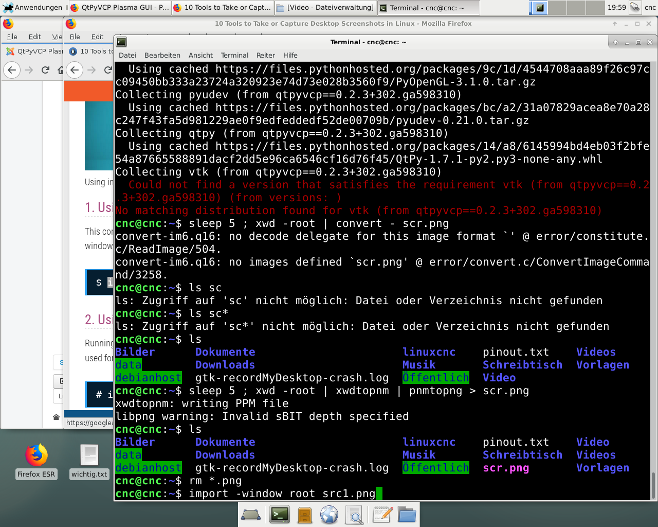

07 Jun 2019 17:46 - 07 Jun 2019 18:01 #136238
by pl7i92
Replied by pl7i92 on topic QtPyVCP Plasma GUI
Last edit: 07 Jun 2019 18:01 by pl7i92. Reason: screenshot
