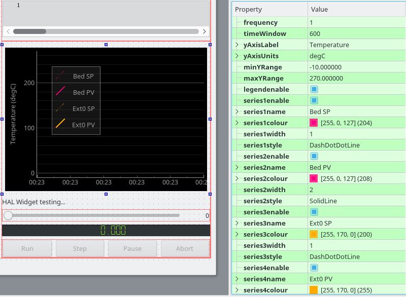

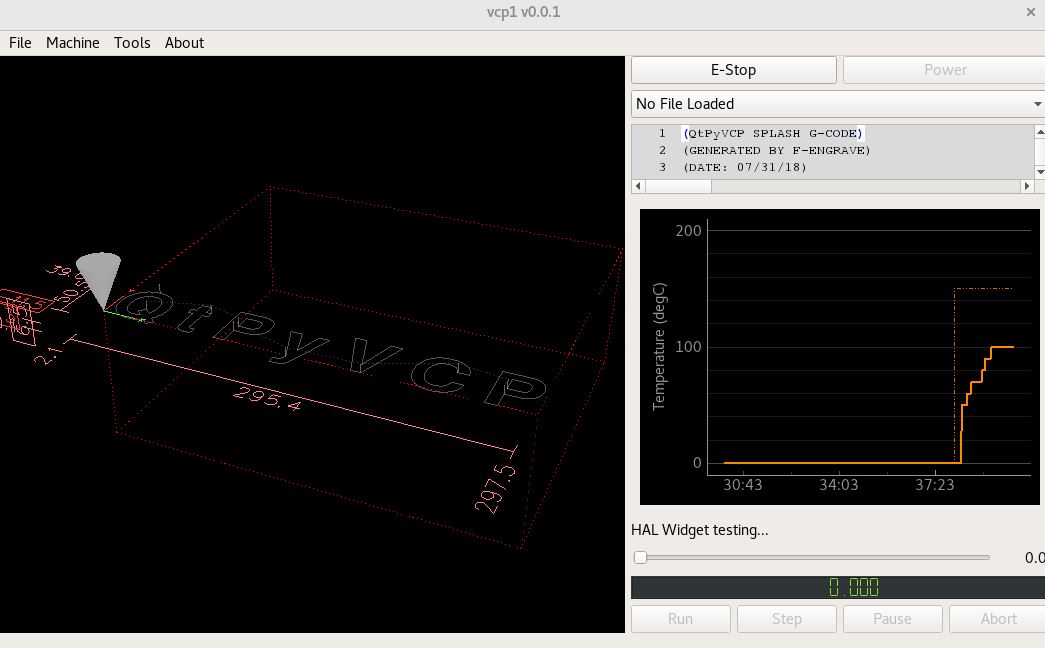

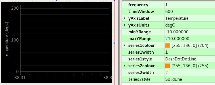

I've developed a HalPlot widget for QtPyVCP. Currently it only can plot two Hal pin inputs as a scrolling time plot. Sample frequency, displayed time window and plot series pen settings are available as parameters in Designer. My intention is to use this in a 3D printer UI but it would be useful in other situations as well.

Definitely! I'm a great believer in open source and sharing. I ended up using pyqtgraph. I will add some additional Hal pin inputs so that a total of 4 series can be plotted. This is what I need for my application. It would be great to add these dynamically but I have no idea how to do this at the moment.

So I think I'm happy to do a pull request on HalPlot. It has all of the functionality that I need now but others may find some more enhancement opportunities.
Up to four HAL pins can be plotted, enabled via Qt parameters, and the exposed qtpyvcp pin is now using the plot series name. Each series has pen settings in Designer and the legend can also be enabled or disabled as required.
