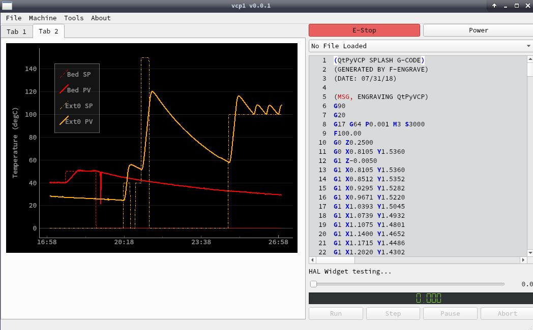

Below is an example of why I wanted to develop the HalPlot widget. PID tuning visualisation. This is a plot of a very out of tune PID loop for my 3D printer temperature control.

I am curious what this does that Halscope doesn't?

The only thing this does is allow the plot to be embedded in the UI as a persistent feature. No need to open Halscope, select pins to watch etc etc.
The widget is definitely less flexible than Halscope.
