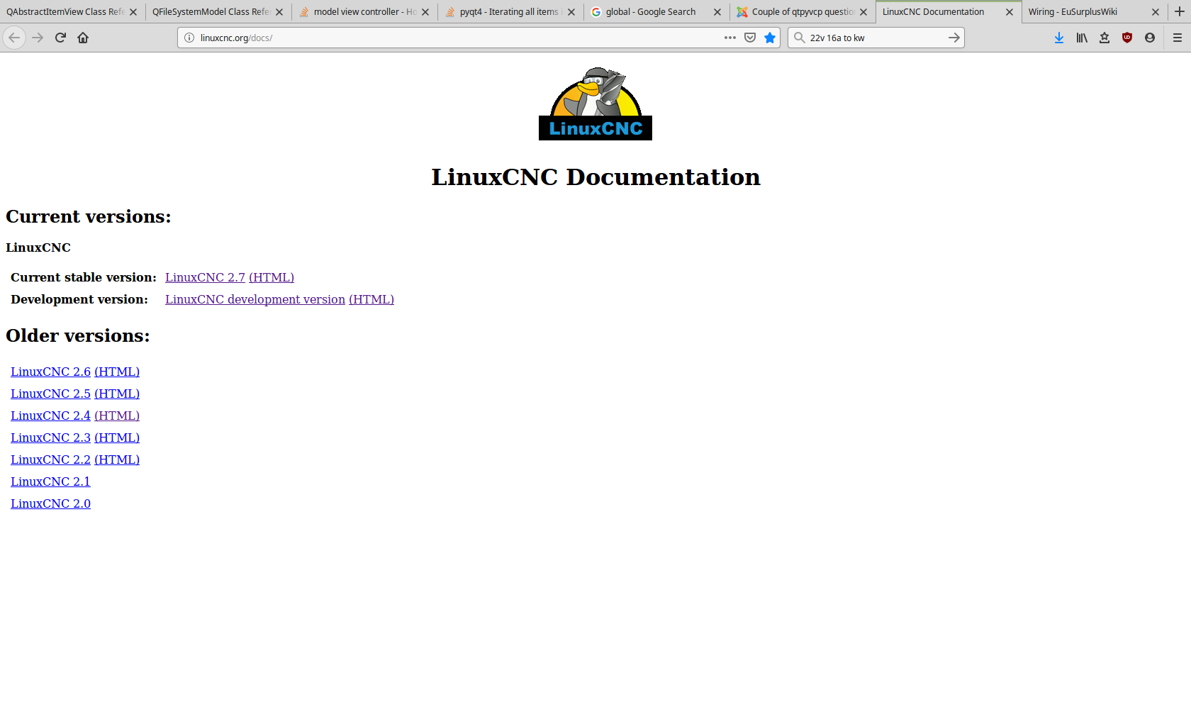

John are you saying that if you click this link:
linuxcnc.org/docs/
you don't see this:
I've been using that link for years.
Chris M
linuxcnc.org/docs/
you don't see this:
Chris M

Hmm I thought linuxcnc.org/docs went to the current docs... I'll have to look into where that is... we seem to have some duplication again with the docs...

It may be handy but it's not maintained any more or part of the WLO so I have no clue where that is even though it's the base url for all the docs... it is not part of the buildbot which is buildbot.linuxcnc.org/doc
