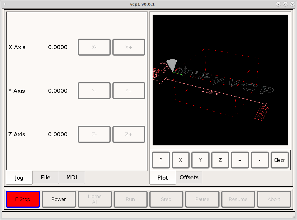

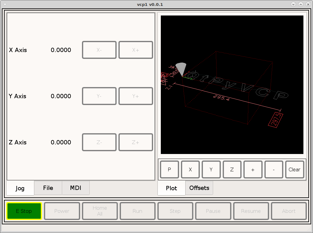

01 Oct 2019 17:44 - 01 Oct 2019 17:48 #146816
by BigJohnT

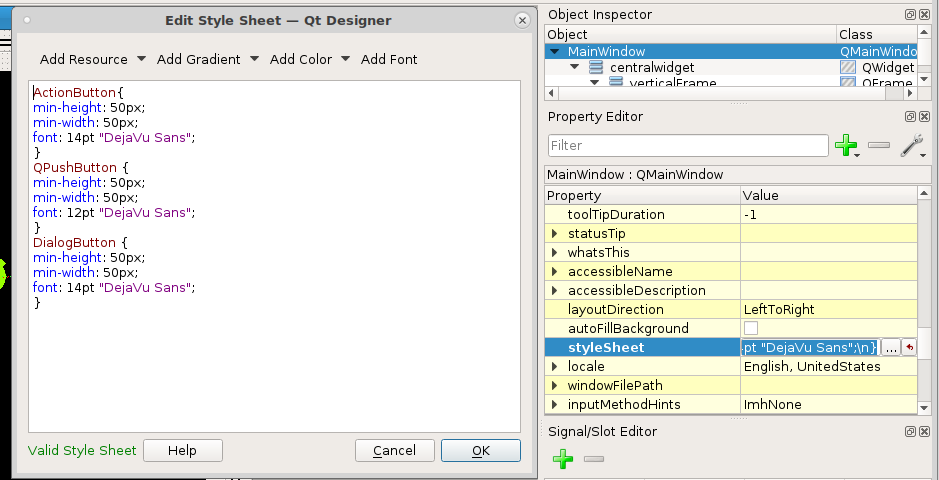

In your Mainwindow stylesheet you had some colors specified there. I removed the line border-color:#00EE00; as it takes precedence over the qss stylesheet IIRC.
This is what I put in the style.qss file. Notice the border is set for all buttons with the first QPushButton definition. The E Stop overrides the general style and if checked or not applies a different style.
JT
Replied by BigJohnT on topic QtPyvcp Button Color Change Based on Stylesheet
I appreciate your help, Big John. I tried different color formats to no avail. I am able to change the mainWindow background color from the stylesheet, but I cannot affect any actionButtons or QPushButtons.
QPushButton {
border: 4px solid grey;
border-radius: 6px;
ActionButton[actionName="machine.estop.toggle"]{
border: 4px solid yellow;
background: green;
ActionButton[actionName="machine.estop.toggle"]:checked{
border: 4px solid blue;
background: red;
}JT

- billnixon
- Posts: 43
03 Oct 2019 20:14 #147025
by billnixon
Replied by billnixon on topic QtPyvcp Button Color Change Based on Stylesheet
That's beautiful. Thanks much.
