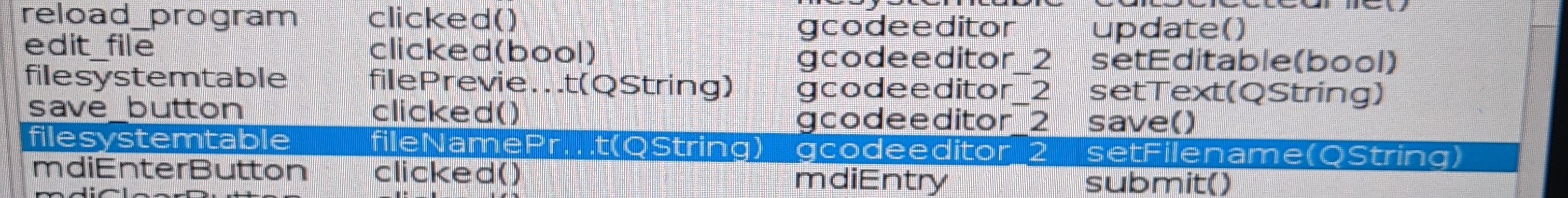

Where can I find information on the GcodeEditor widget in qtpyvcp? I have dragged the GcodeEditor widget into a frame and added some pushbuttons connected to slots for gcodeeditor below the wwidget. Files from FileSystemTable open in the editor.
Here are some of my problems:
1) Files are not editable.
2) The find function works, but not replace.
3) The "Save As" function does not actually save a new file.
I connected a pushbutton to the slot "setEditable(bool)" but that didn't seem to change anything.
I appreciate your help.

if you are trying to edit example gcode programs, such as 3dchips etc.. they are protected and the editor will not change them. try physically saving and renaming them in another folder and retest to see if your gcode editor works. we have it working great in probe basic, you could install that and see how the connections are setup.

Does it update with qtpyvcp of is there another branch to sync. My copy doesn't have any signals set for saving the file. I have gotten as far as getting the selected file into the plain text widget
I am able to edit in the gcode editor.
I set a button as checkable and a signal for when toggled set editable and I can edit.
I have not been able to successfully save it

I also had to set the edit button to "checkable"

Save as is working properly for me since adding the signal I was missing

I was able to install probe_basic and noticed that its g code editor is gcodeeditor_2. Mine is only gcodeeditor and does not seem to have a setEditable slot. While I am editing probe_basic, the QtPyVCP input widget named GcodeEditor drops gcodeeditor_2 with the drag and drop. Unfortunately, when I am editing my gui, the same input widget only gives a gcodeeditor widget, not a version 2. How can I remedy this?

The reason is probe basic has 2 gcode editors, and when you add the second it puts the _2 after it.
I had to make the button checkable to have it set edit mode on the gcode editor
