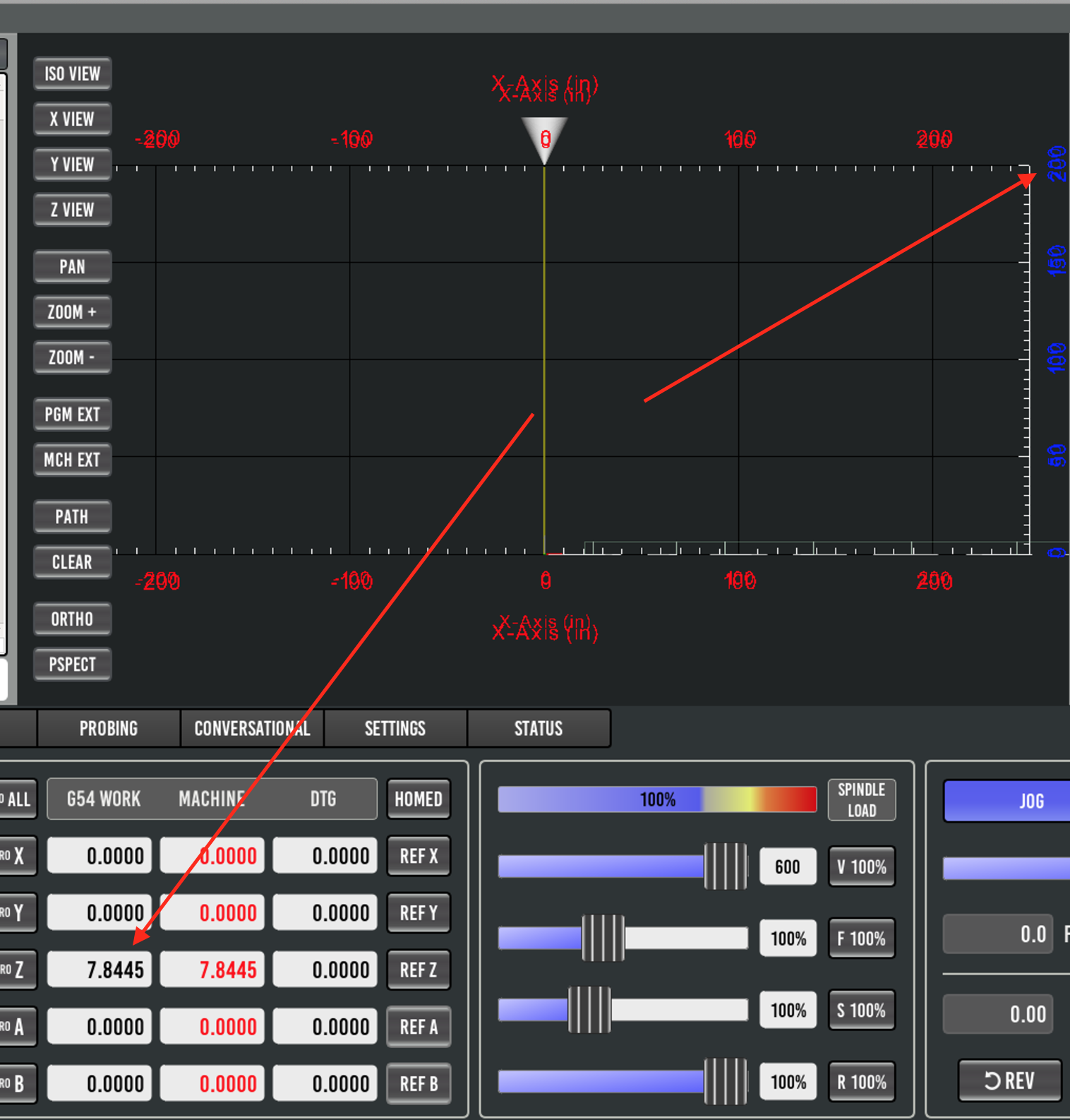

Probe_Basic Metric was created by Gnevko

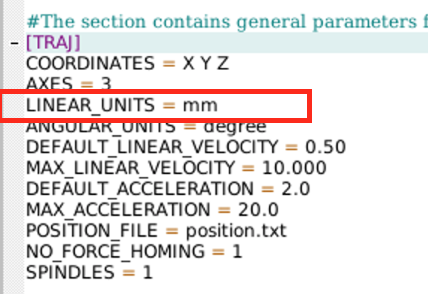

This solved the problem:
[RS274NGC]
PARAMETER_FILE = linuxcnc.var
RS274NGC_STARTUP_CODE = F10 S300 G21 G17 G40 G49 G54 G64 P0.001 G80 G90 G91.1 G92.1 G94 G97 G98
SUBROUTINE_PATH = subroutines/
[RS274NGC]
