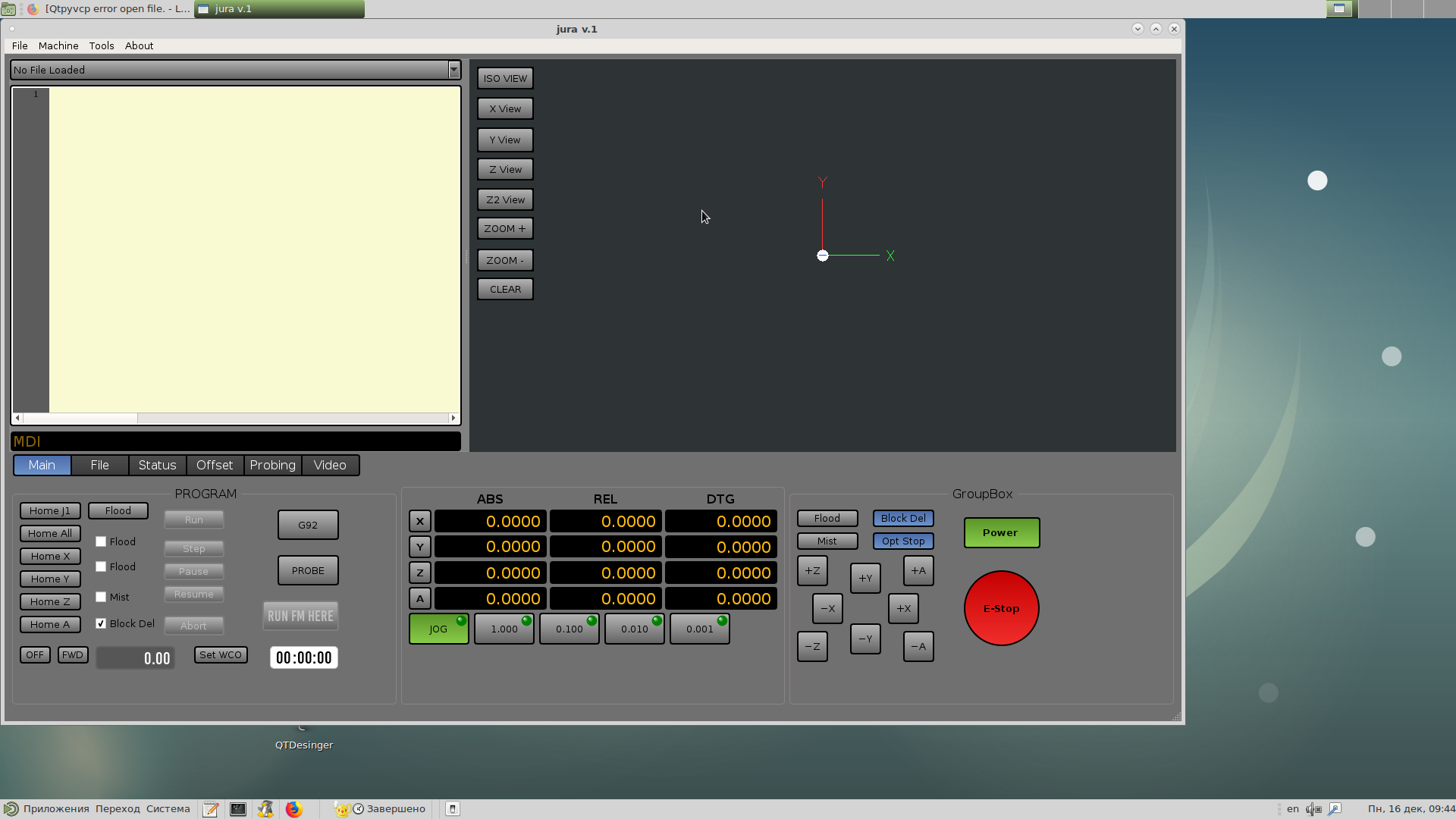

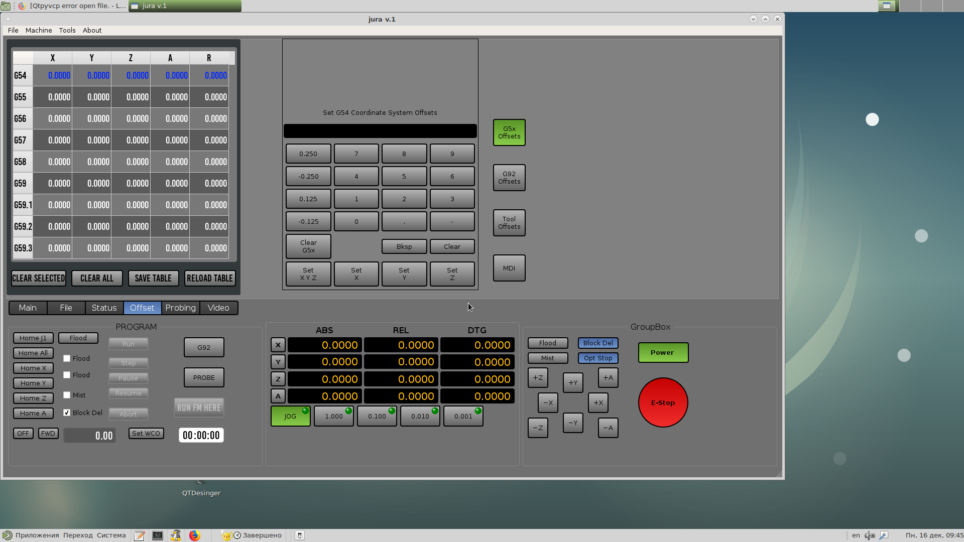

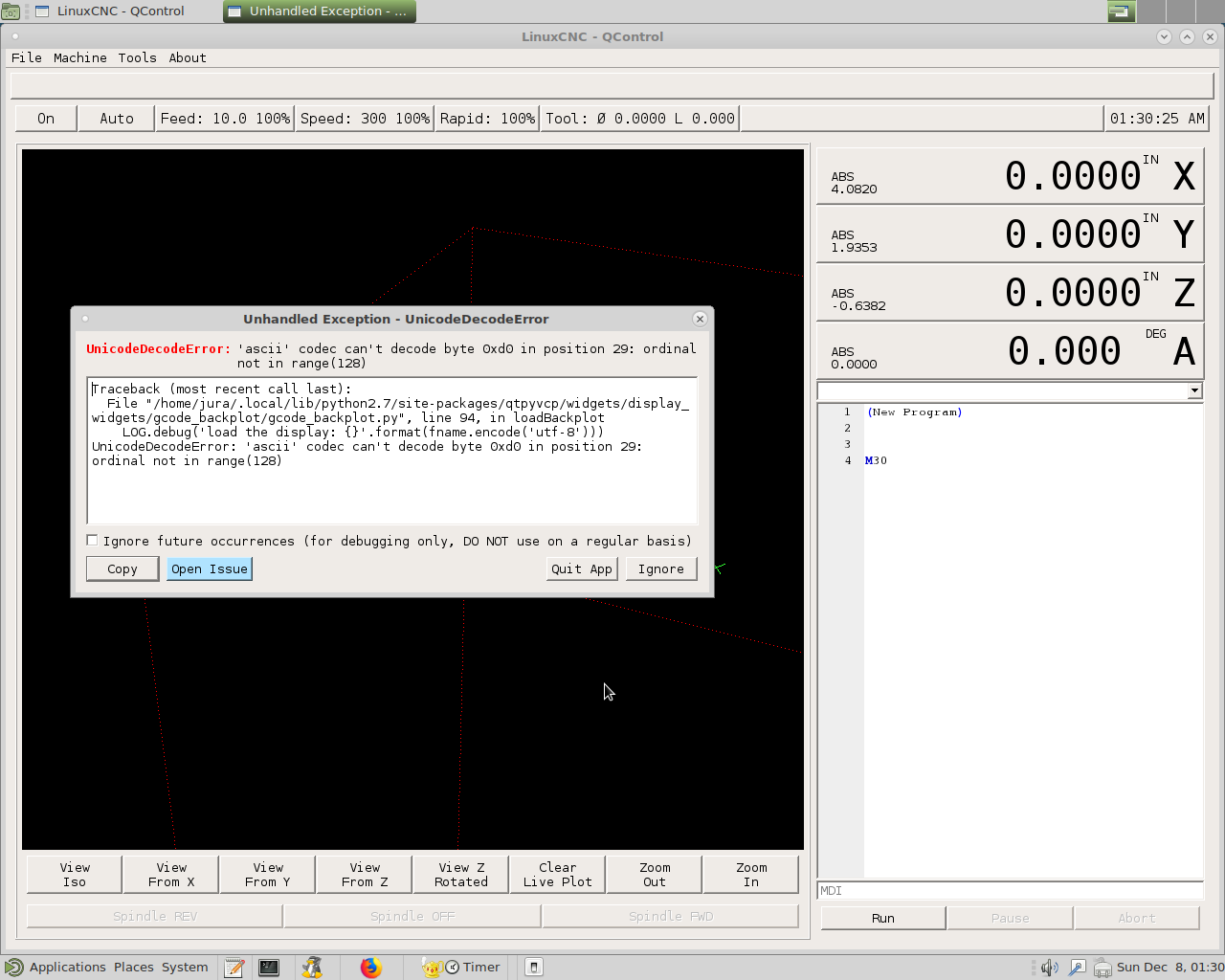

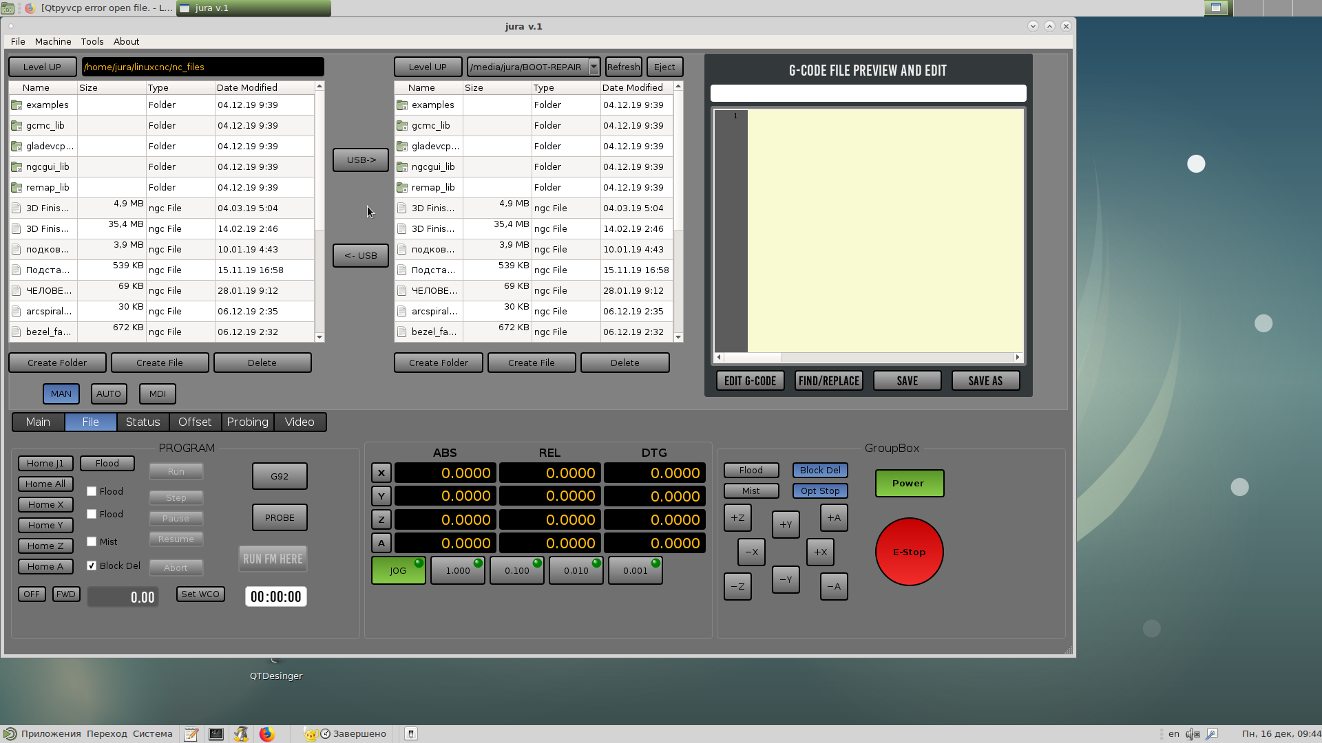

Hi! Comment please errors . File download image in G54 no G92. Please tell me how to fix this. Or where to read. The file is loaded in the GcodeBackplot window. I'm trying to build for myself an interface based on the Qtpyvcp Brender test. I will share the final result with pleasure. Thank you all for your hard work. Sorry mit englisch.

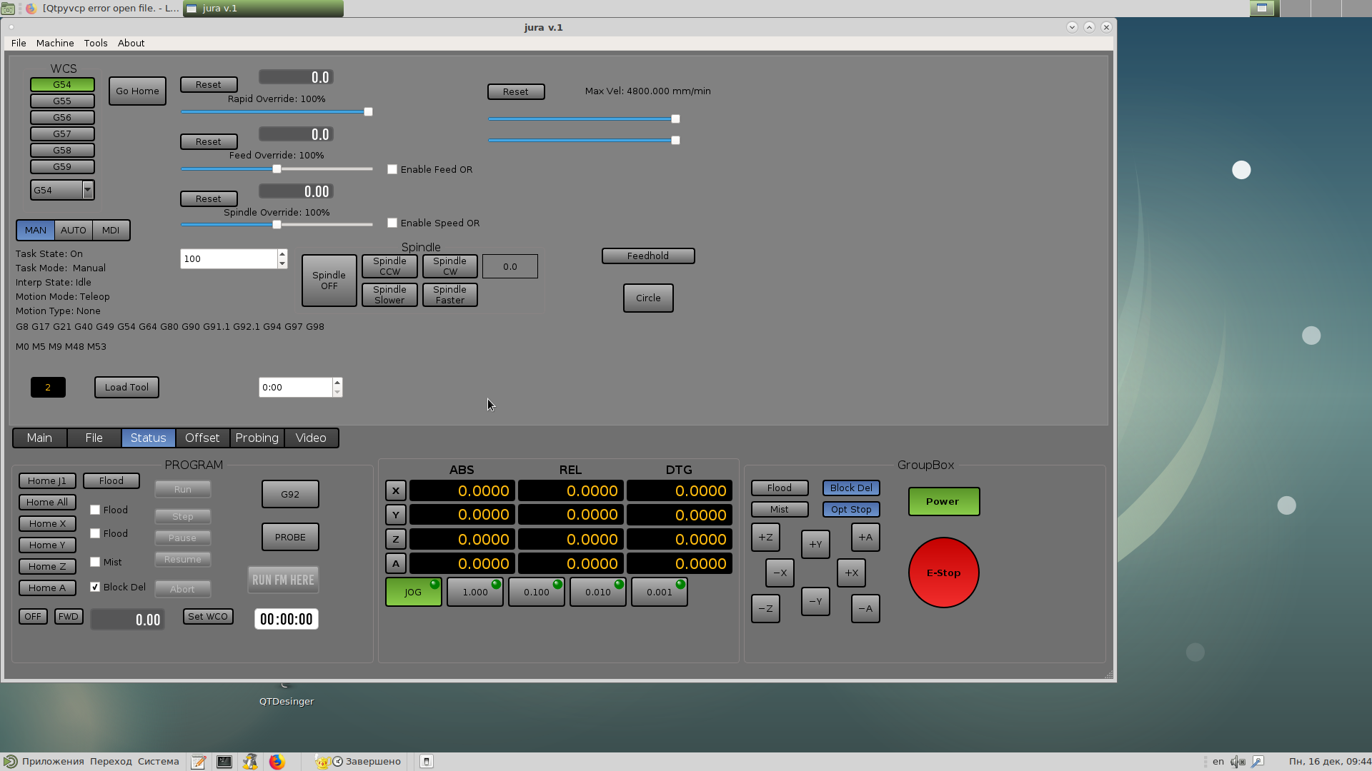

I dealt with the first question, deleted G92.1 from this line RS274NGC_STARTUP_CODE = F10 S300 G21 G40 G49 G54 G64 P0.001 G80 G90 G91.1 G94 G97 G98. And with a decoder I can’t find anything on the Internet. Please help someone who can.

Can you post the error.
It will yell at you if you have a program with an in defined axis (a on an XYZ machine for example)
It looks like it doesn't like the format of the thing listed in that error

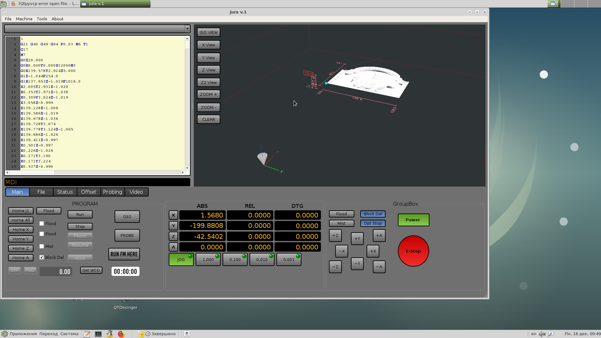

I figured out the coordinates and explained in the first message, and gcode Backplot does not decode the Cyrillic alphabet, that's all. I still have a problem with the Probing page that I got with Probe Basic where it apparently does not work. I took up this interface because it works well with large files. This is necessary for woodworking. And by the way gcode Editor displays 4 characters line number.
