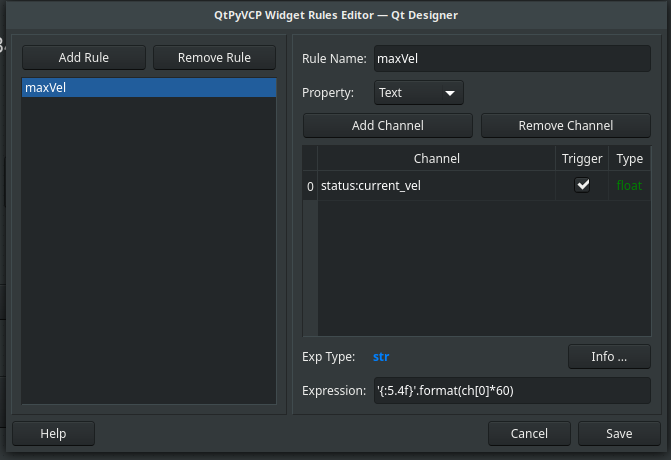

13 Dec 2019 22:48 #152620
by Donb9261
Replied by Donb9261 on topic QtPyVCP - Max_Velocity Override - Button Group Freebie
Do you have a TRAJ section in your ini file? If so, what is the value. For this to work you have to have a TRAJ section with MAX_VELOCITY. It is units per second. How do you have your label format set to see the returned value in the UI?

13 Dec 2019 23:22 #152625
by Leon82
I'll double check, I was using the plot and label and they both seemed to match. I know it works correctly as I was using while cutting
Replied by Leon82 on topic QtPyVCP - Max_Velocity Override - Button Group Freebie
Here is the label rule for my max_velocity label. It scales to IPM or MMPM. So whatever your settings are. Max_Velocity is UNITS PER SECOND so it is inch or metric agnostic.
If this is not set correctly then you will not see a valid change in the value of the label.

14 Dec 2019 02:54 - 14 Dec 2019 02:56 #152637
by Leon82
Well, now I feel like a horses patoot.
I had a space in front of the action and the only one that didn't have one was zero.
It is working good.
I couldn't try your vcp2 because that's the same name as mine and I didn't want to try and rename them LOL.
My status label is actually reporting rapid override so I'll have to change it.
100 =150 on it
It is working good.
100 =150 on it
