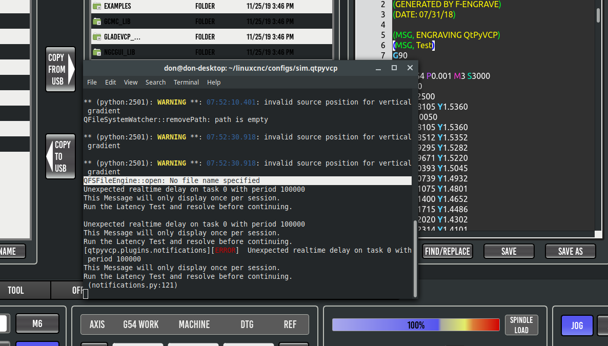

From what I am gathering there is little info on this message. But, it appears using the slot as is:
does not extract the file name and path of the currently open .ngc file loaded in the editor. I have tried the save button in probe_basic as well and see the same error when I edit the open gcode file and then click save. The debug message in the terminal drops: QFSFileEngine::open: No file name specified.
This means that save_file is returning empty.
Is it an issue with the def or an issue with usage of QFile?
Has anyone had this issue? If so, what is the fix?

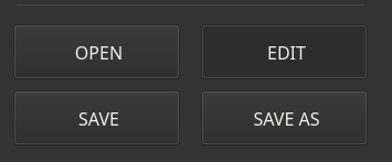

Also, it appears that save_as() saves the file into the main vcp directory vice the nc_files directory. Does the path need to be appended in the gcodeeditor.py to include the full path to where one would want the files saved. If so, any ideas on how to make the change so that if I use save_as() it saves to say /home/me/linuxcnc/configs/myvcp/nc_files.
I would like both save() and save_as() to work but currently neither performs as expected.

IT only works if the file is opened through the FileSytemTable widget. Issue for me is I may not want to use that.
Using the FileSystemTable widget, double clicking or using the load gcode presents the path to the file_absolute_path QLabel. What I am hoping is to find a way to get that absolute path stored in a variable when the file is loaded using the open button. I know there is a way but I just have not found it.
It appears to not be a bug but a functional flow concern on my part. The file system widgets take considerable screen real-estate and I want preserve that as much as possible to simplify the interface.

Found a way! Works great.
In the gcodeeditor.py file I added a new slot called saveMyFile(self). Then added the following and it works. I call in the current file from Linuxcnc and then set that as the QFile path. Now you can have save without using the FileSystemTable. Valuable screen real estate loss. Also, falls in line with Fanuc as far as not having to manually reload from an external editor.
Adding the extra slot allows the original functionality to work with the FileSytemTable. No breaking changes.
Now just need to get the default directory setup for save_as(). Currently saves to main vcp directory.
Set to EDIT_Mode>>Make Edits>>Click Save>>File saves and reloads at line 1 automatically.
