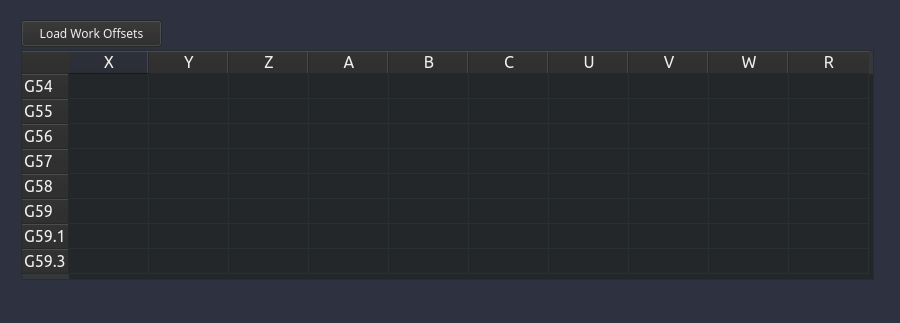

All,
This is a work in progress but coming along fairly well.
I am able to load the work offset via the .var file in the config and then insert each offset into a QTableWidget by row per offset (G54 ~ G59.3).
Currently it works via a QPushButton for dev. But, on final the offsets will load when the QMainWindow loads and will be editable (Future Release will have user level privileges based on security policies ie.. Operator, Skilled Operator, Master Operator). And like the tool table, highlight the active offset based on the planner status.
Just wanted to get some feedback in reference to what UI elements might need to be included.
I will most likely stick to the standard editing tactic as per most other controllers. When a change is made to the cell data the data is written back to the .var file and then the table reloads with the new current value. But, does not set the active offset. As with most controllers if the offset is edited you must specifically recall the offset via MDI or some other means as the work offset is modal and should never be changed outside a controlled environment or while cutting.

In any case a couple screenshots to get your mind working...
Pre-Button Click Event

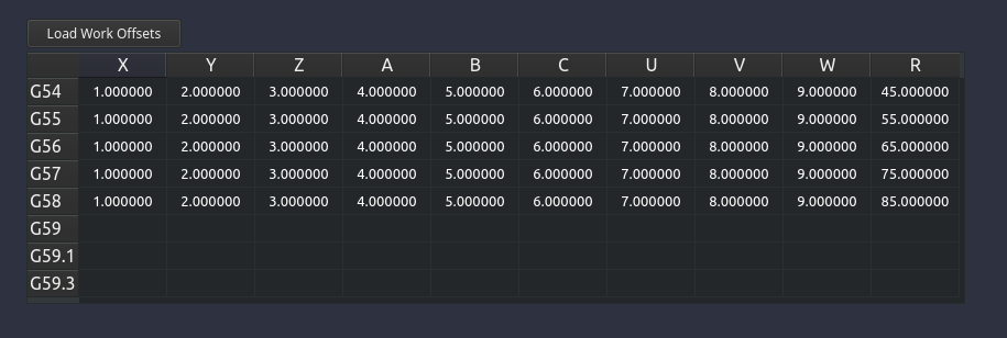

Post Button Click Event (The values for each group are the same except R) (But all are unique to the respective offset)

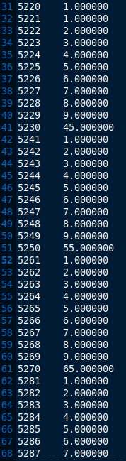

Vars

Looking through the commands there is not a load_work_tabel() function like there is for load_tool_table(). Knowing this is a LCNC mainline function and not tied to QtPyVCP, is there a method that could be created to force LCNC to read in the offset table. It does whenever you do G10 L2 Pxx XYZABCUVWR otherwise after using the G10 L2 to set say G55 to X-3.4567 like so G10 L2 P2 X-3.4567 and then subsequentlay calling G55 later you would get the old value. Which you do not.
From my understanding, the .var file is loaded upon reading the .ini file. Restarting the control is obviously not an option.
So I suppose there has to be a function triggered by the G10 L2 that forces the planner to pick up the new offset data. Scratching my head.

Found this from the GladeVCP project. It should work. Just have to collect all the table edits made and submit one at a time through a for loop calling G10 L2 Pxx XYZABCUVWR for each offset. Then switch from MDI to Manual and back to MDI will force the var file write function and recall. I suppose the thought was if you execute a G10 L2 you must be in MDI anyways.
Gonna take a lot of code and head scratching make this work. How fun...

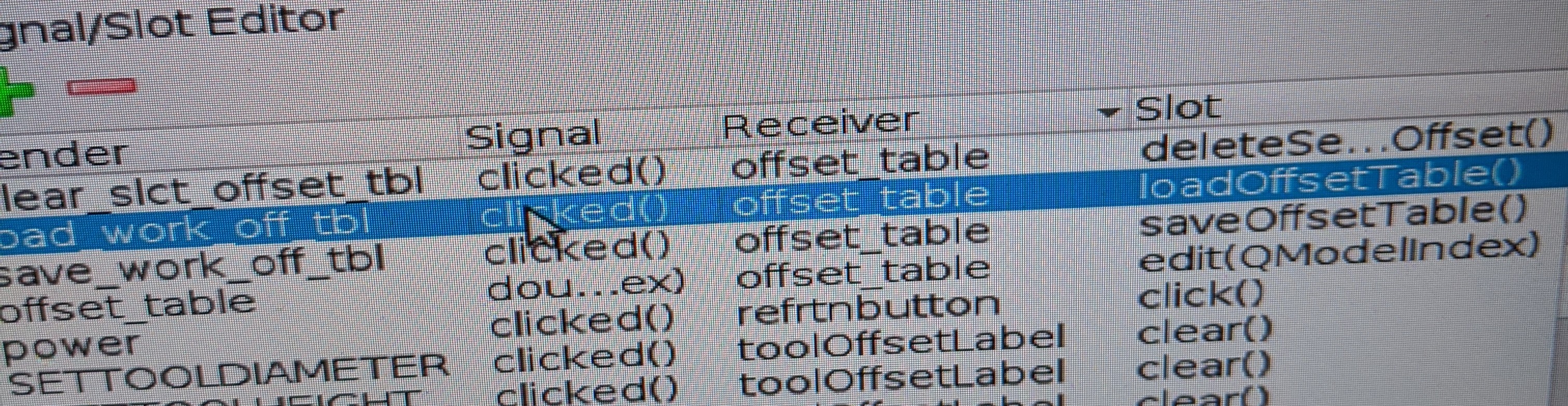

27 Dec 2019 21:05 #153315
by Leon82
Replied by Leon82 on topic QtPyVCP - Work Offset Table - WIP
- Donb9261
- Posts: 169
- Thank you received: 103
27 Dec 2019 22:00 #153322
by Donb9261
Replied by Donb9261 on topic QtPyVCP - Work Offset Table - WIP
Is that slot in the GladeVCP project or QtVCP or QtPyVCP? Or did you develop that slot yourself?
- Leon82
- Posts: 592
- Thank you received: 79
27 Dec 2019 22:42 #153327
by Leon82
its in the qtpyvcp
i didnt add anthing special. i noticed it in probe basic also
its in the qtpyvcp
