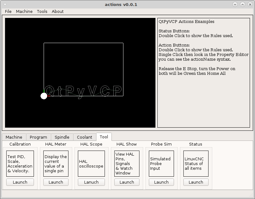

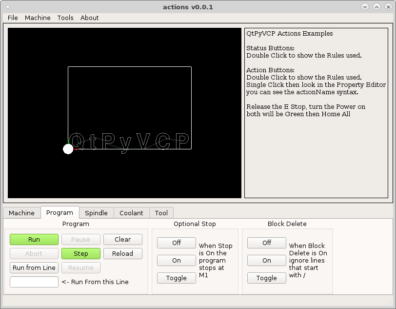

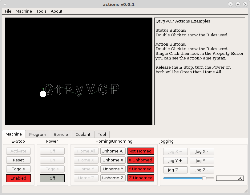

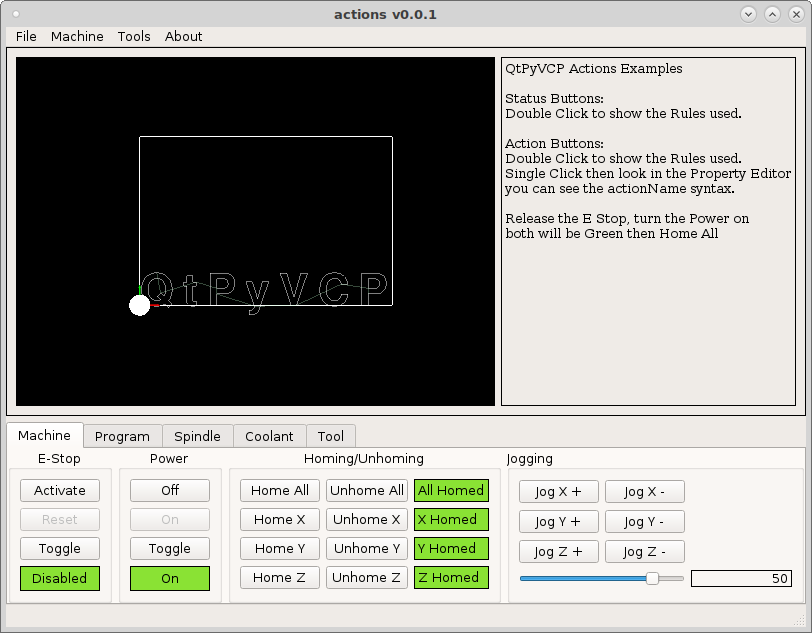

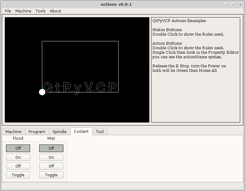

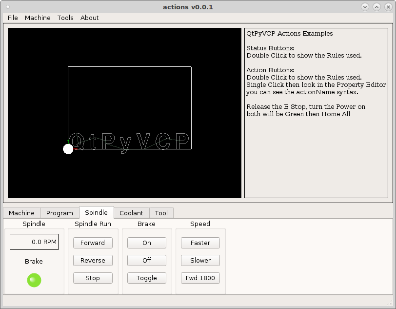

I just wrapped up my QtPyVCP Actions Example GUI that show every action as well as many status items. You can open the actions up in Designer just copy and paste into your GUI. You can also see the syntax for the rules I used.
It's in the master branch nowIt's in a branch at the moment of QtPyVCP called action_examples or you can get it from my github repo
github.com/jethornton/qtpyvcp_actions
Machine Actions
Machine Actions after turning on and homing is done
Program Actions
Spindle Actions
Coolant Actions
Tool Actions

Machine Actions
Program Actions
Spindle Actions
Coolant Actions
Tool Actions
