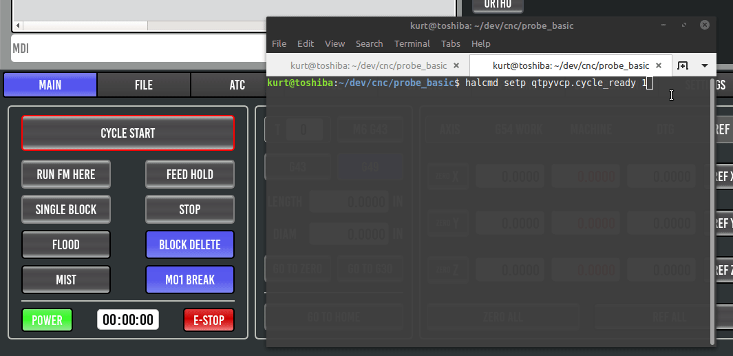

I am trying to setup my lathe up so that before allowing a cycle start the collet closer has ample psi as well as the door being closed.
My code for checking the status of the two requirements is:
loadrt and2 names=cycle_ready
addf cycle_ready servo-thread
#NOTE:qtpyvcp.airpressure.checked and qtpyvcp.doorclosed.checked is for development, the physical mesa card pin will inserted.
net air_ok qtpyvcp.airpressure.checked => cycle_ready.in0 ##
net door_ok qtpyvcp.doorclosed.checked => cycle_ready.in1
net all_ok => cycle_ready.out
From this I would like to have an indicator on my qtpyvcp that 1.) Displays the Cycle Start button green if cycle_ready is true red if false. and 2.) I want to indicate on the panel a green led if collet is closed and a red led if open.
I have tried setting qtpyvcp.cycle_ready to TRUE as well as 1 but I am coming up short on how to interact between the two. . I have read about the widgetRules process but I can't find a status rule that would allow me to status the cycle_ready pin. Can someone point me in the right direction on what I should read or examples I could study to archive this? As a side question I read in a post that a plug-in was being written to enable the hal pins in the channel selection. Is this plug-in available?

Replied by KCJ on topic Status of hal pin- to change hal button or led?
The easiest way to do this right now is probably to add a little code to the VCP's mainwindow python file. For probe basic this would be the probe_basic.py file.
In the import section at the top of the file add
Add this to the end of the __init__ method
Add this method anywhere in the mainwindow class
Then in your POSTGUI_HALFILE connect your pin to the pin we just created
This will cause the border of the widget named cycle_start_button to change to red when the qtpyvcp.cycle_ready.in pin is low, and true when the pin is high.
NOTE: If you are using probe basic the name of the cycle start widget is actually actionbutton_3
You can add a HalLedButton to indicate the status of the collet closer, and connect it in your POSTGUI_HALFILE. There is no need to add any python code for that since the widget takes car of creating and watching its HAL pin.
See: www.qtpyvcp.com/widgets/hal/index.html?h....hal_widgets.hal_led
from qtpyvcp import halAdd this to the end of the __init__ method
hal_comp = hal.COMPONENTS['qtpyvcp']
# add a cycle_ready pin to the default qtpyvcp hal component
self._cycle_ready_pin = hal_comp.addPin("cycle_ready.in", "bit", "in")
self._cycle_ready_pin.value = self.isEnabled()
self._cycle_ready_pin.valueChanged.connect(self.onCycleReadyPinChanged)Add this method anywhere in the mainwindow class
def onCycleReadyPinChanged(self, value):
if value:
self.cycle_start_button.setStyleSheet('border-color: green')
else:
self.cycle_start_button.setStyleSheet('border-color: red')Then in your POSTGUI_HALFILE connect your pin to the pin we just created
net cycle_ready.out => qtpyvcp.cycle_ready.inThis will cause the border of the widget named cycle_start_button to change to red when the qtpyvcp.cycle_ready.in pin is low, and true when the pin is high.

Close but not there yet.
After playing with the location and spacing syntax for a while I came up with:
class ProbeBasic(VCPMainWindow):
"""Main window class for the ProbeBasic VCP."""
def __init__(self, *args, **kwargs):
super(ProbeBasic, self).__init__(*args, **kwargs )
if value:
else:
It appears the new pin is in fact being created in the qtpyvcp but I get an error from saying that custom_postgui.hal:11 PIN 'qtpyvcp.cycle_ready.in' does not exist. Line 11 is net cycle_ready.out => qtpyvcp.cycle_ready.in
Any thought would be appreciated. I am hoping that I have added the lines properly to the probe_basic.py file.

14 Mar 2020 01:21 #160113
by KCJ
I have attached a complete working probe_basic.py file with the needed changes.
I tested it by adding this line to my POSTGUI_HALFILE
If you want to quickly check what HAL pins the current VCP has you can run
Let me know if you still run into missing HAL pin errors.
Cheers,
Kurt
net estoped halui.estop.is-activated => qtpyvcp.cycle_ready.inIf you want to quickly check what HAL pins the current VCP has you can run
halcmd show pin qtpyvcpLet me know if you still run into missing HAL pin errors.
Cheers,
Kurt

How are you installing QtPyVCP / ProbeBasic? It could be that you are not actually running the modified files, so the HAL pin is not being created.
Since you are modifying files within ProbeBasic you will need to install from your local directory containing the changes.
First uninstall any existing version of ProbeBasic (run multiple times until you get a red error in the terminal)
Then from your probe_basic directory run
This will create what is called a development install, and will allow you to modify files within probe_basic and have the changes be picked up next time you start it without needed to reinstall after each change.
Hope that helps!
Kurt
pip uninstall probe_basicThen from your probe_basic directory run
pip install -e . --no-depsThis will create what is called a development install, and will allow you to modify files within probe_basic and have the changes be picked up next time you start it without needed to reinstall after each change.
Hope that helps!

Thanks for the help. I spent many many hours on this without success. I then decided to go drastic! I formatted the hard drive and did a clean install of everything. Now it is working. Happy that worked, because plan C for this problem would have involved a sledge hammer, and colorful language. Again thanks for the help and patience.

Glad you got it to work!
I need to find an easier way for people to do simple customizations to VCPs like this without needing to change files in the VCP it's self.
