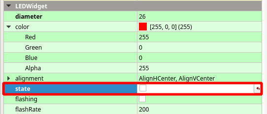

Hello I have a question about the Hal led widgets. They seem to need a change input before they work properly. They allways start red even if the signal is low. After the signal switched they work correctly. What am I doing wrong?

have used the qt designer (what can I post to help here) to add the Hal button and led
in my Postgut Hal is following section:
they work fine after being toggled but before they are always on even if the state should be off.
thanks Patrick
#E-stop
net reset <= qtpyvcp.hb1.out
net reset => qtpyvcp.led4.on
net estop-button => qtpyvcp.led1.on
net i-pressure-ok => qtpyvcp.led2.on
net i-temp-bimetall => qtpyvcp.led3.on
net latch-out => qtpyvcp.led5.onthey work fine after being toggled but before they are always on even if the state should be off.

Hello Patrick,
Sorry for the long delay, I've been extremely busy with real work!
There is no way for the HAL widgets to know what state to start up with. Since the connections are done in HAL, the widget does not know what pin it is connected to.
What you should do in this case is either configure the initial state of the widget to match the default HAL pin state in QtDesigner (see attached screenshot), or better, explicitly setp the LED input pin in your postgui HAL file.

no worries, this is just hobby an a minor detail of my gui.
I use this pins to see if something went wrong during power up. So just setting the state they should have doesn't help me if there comes an error signal from the control before linuxcnc is has started.
Can I use setp with getp in one line?
like
setp qtpyvcp.led1.on getp estop-button
this would bring me the results I want to have without too much trouble.
