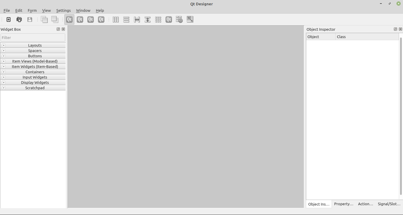

Hello,
OS: 64bit Linux Mint 19.3
I am having trouble locating LinuxCNC-specific widgets and the widgets rules editor.
I followed the Installation process on the qtpyvcp website, including the development part.
Everything seems to be in order: QtDesigner works fine, LinuxCNC launches with the gui's made in QtDesigner.
However, there are no LinuxCNC widgets in the 'Widget Box' pane in QtDesigner.
So, how do I access these widgets?
Screenshot of my view of QtDesigner.

Did you install the development stuff from the tutorial?

I followed your instructions and installed wheel. I then reinstalled qtpyvcp per the instructions on the website.
I then ran 'editvcp' on a gui I was working on. Still no LinuxCNC-related widgets.
However, I did notice this error message in the terminal:
Starting QtDesigner ...
qt5ct: using qt5ct plugin
qt5ct: D-Bus global menu: no
[qtpyvcp-designer.plugins][CRITICAL] Error initializing plugin: qtpyvcp.plugins.status:Status(*[], **OrderedDict([('cycle_time', 75), ('report_actual_pos', False), ('use_program_units', True), ('metric_format', u'%9.3f'), ('imperial_format', u'%8.4f')])) (__init__.py:56)
File "/home/username/qtpyvcp/qtpyvcp/widgets/qtdesigner_plugin.py", line 34, in <module>
loadDataPlugins(CONFIG)
File "/home/username/qtpyvcp/qtpyvcp/plugins/__init__.py", line 52, in loadDataPlugins
obj = plugin(*args, **kwargs)
TypeError: __init__() got an unexpected keyword argument 'imperial_format'

New info:
In QtDesigner, I selected Help>>About Plugins. This opened a window that listed the plugins, both working and failed.
Under the Failed Plugins, I found this error report:
Cannot load library /usr/lib/x86_64-linux-gnu/qt5/plugins/designer/libpyqt5_py3.so: (libpython3.5m.so.1.0:cannot open shared object file: No such file or directory)
I followed the specified filepath and found that the file "libpyqt5_py3.so" did exist.
Then, I searched for "libpython3.5m.so.1.0". I didn't find any instance of it, but I did find
"libpython3.6.so" and "libpython3.6m.so" in the filepath: "/usr/lib/python3.6/config-3.6m-x86_64-linux-gnu"
So it looks like QtDesigner is looking for an outdated version of libpython. I will research this further.

Did you find a solution to this? I'm having the exact same problem. I am running Mint 19.3 with 2.8..
John
I followed the instruction in this InstallQtVCPQtDesignerPlugins.tar.gz. I am trying to find where I came across it.
Found it: It is the first attachment in this post. Thanks hottabich.

Well, I had the LinuxCNC-specific widgets for a day. After an update of LinuxCNC the widgets are gone again.
