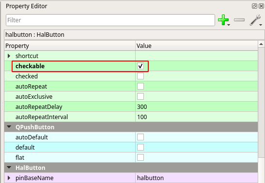

The actual Flood coolant is switched by a valve and woks well.
Till now I do it via s abut call button and a Madi script, but I forget to turn on the pump before I start start a program.
So I would like to change to a Hal button, so I can switch the pump on afterwards or even switch it of while a program is running.
I can't combine it withe the valve, cause I also use the pump to hose down the machine.
But the Hal button only switched on the pump as log as I press the button. Is there a way to get it to toggle? I managed to get the color to toggle but not the signal.

Hello Patrick,

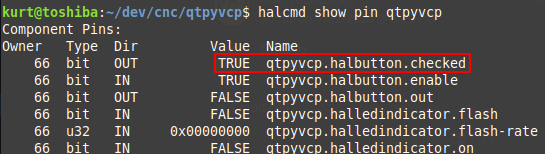

The HalButton will generate a checked hal pin that will be true whenever the button is checked.
You will of course need to make sure you have the button set as checkable in QtDesigner.
Once you have set the button as checkable a halbutton.checked pin will be automatically generated.
(It used to be generated regardless, I have just made a change so it is only generated when the button is checkable to prevent confusion.)

Thanks, I didn't take a look at the hal pins after I found checkable!
