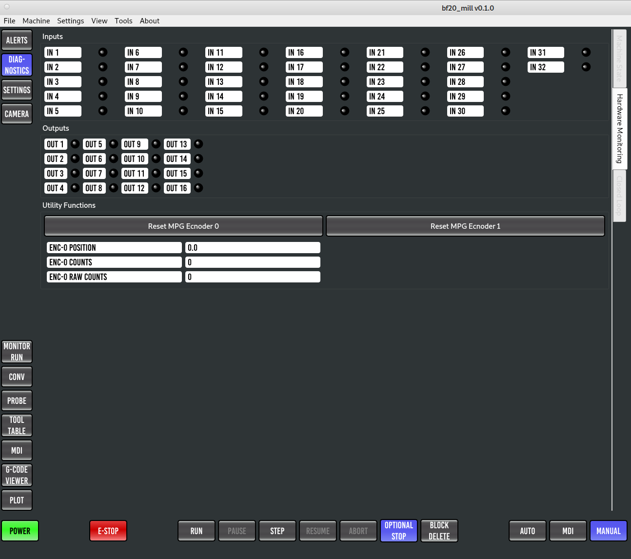

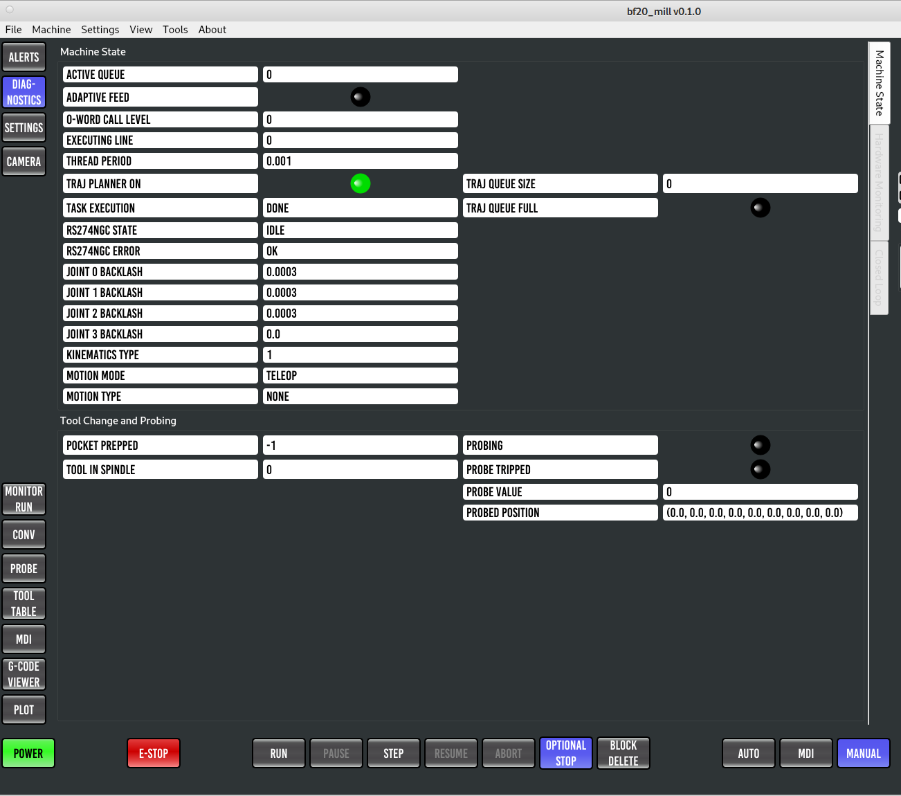

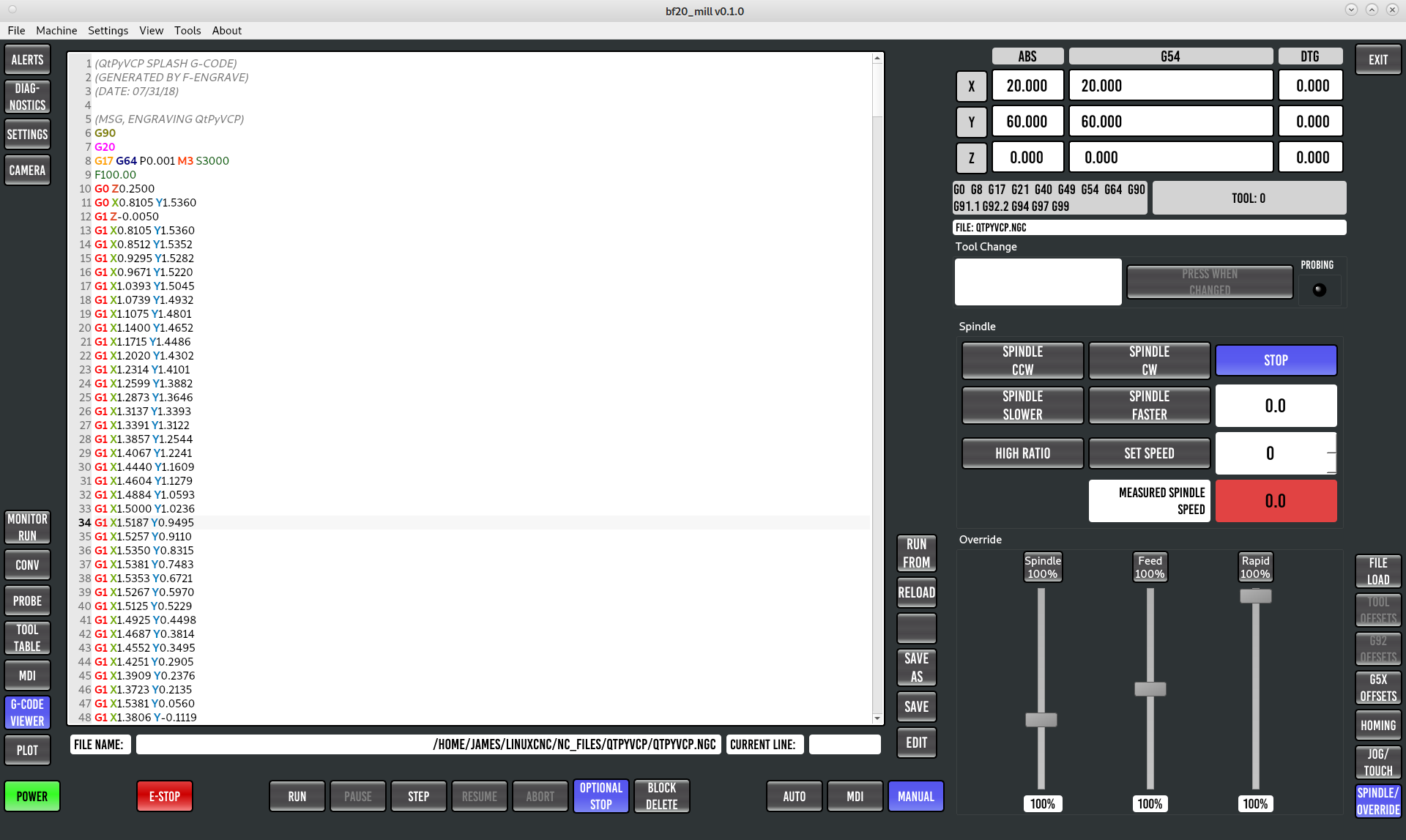

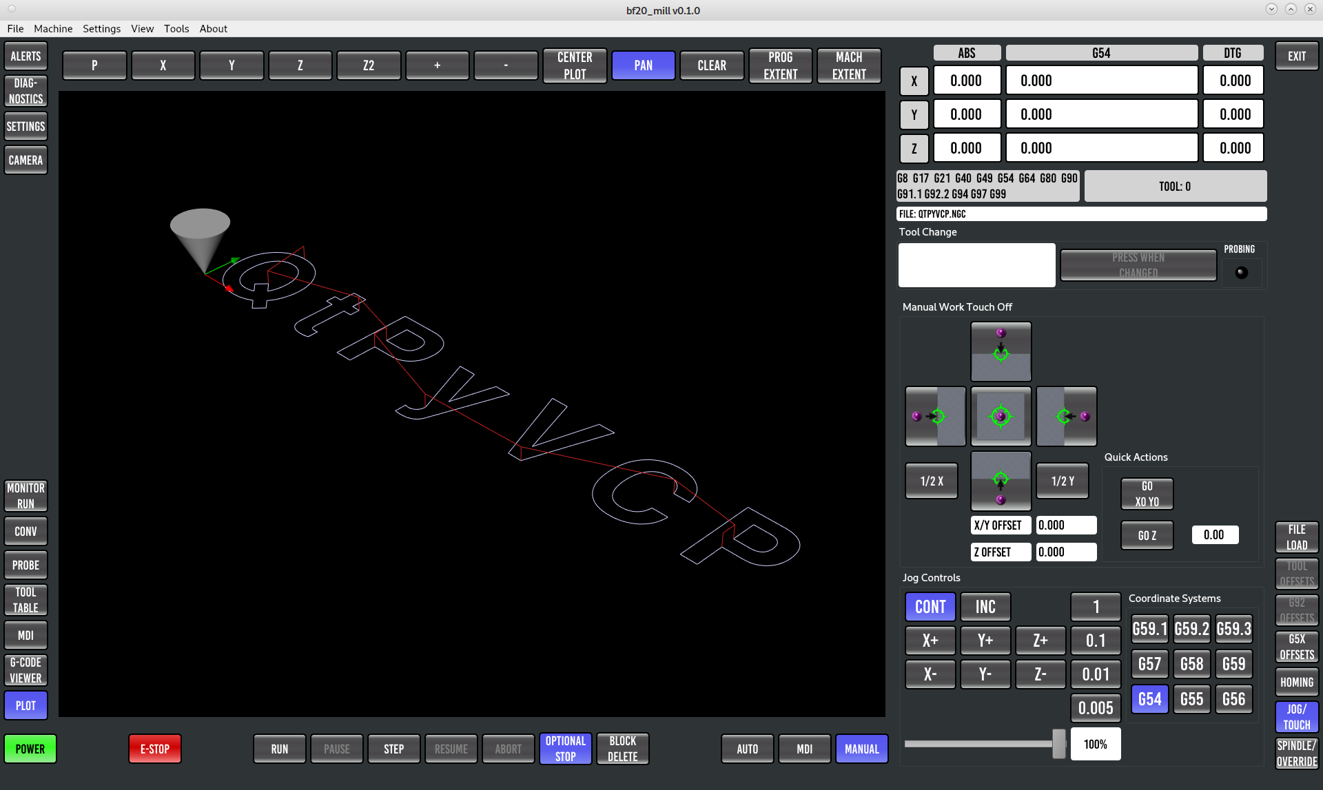

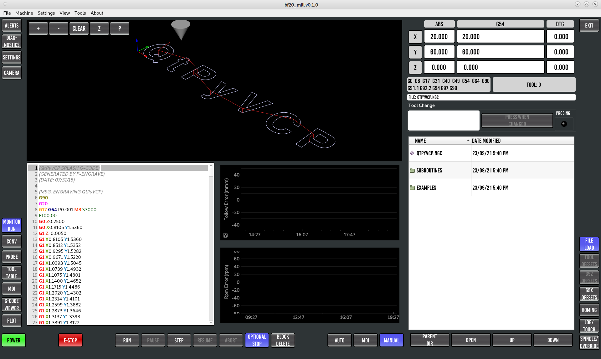

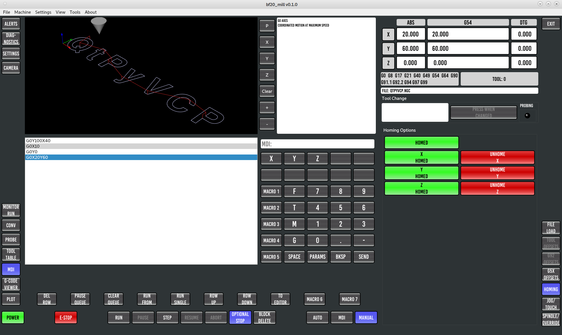

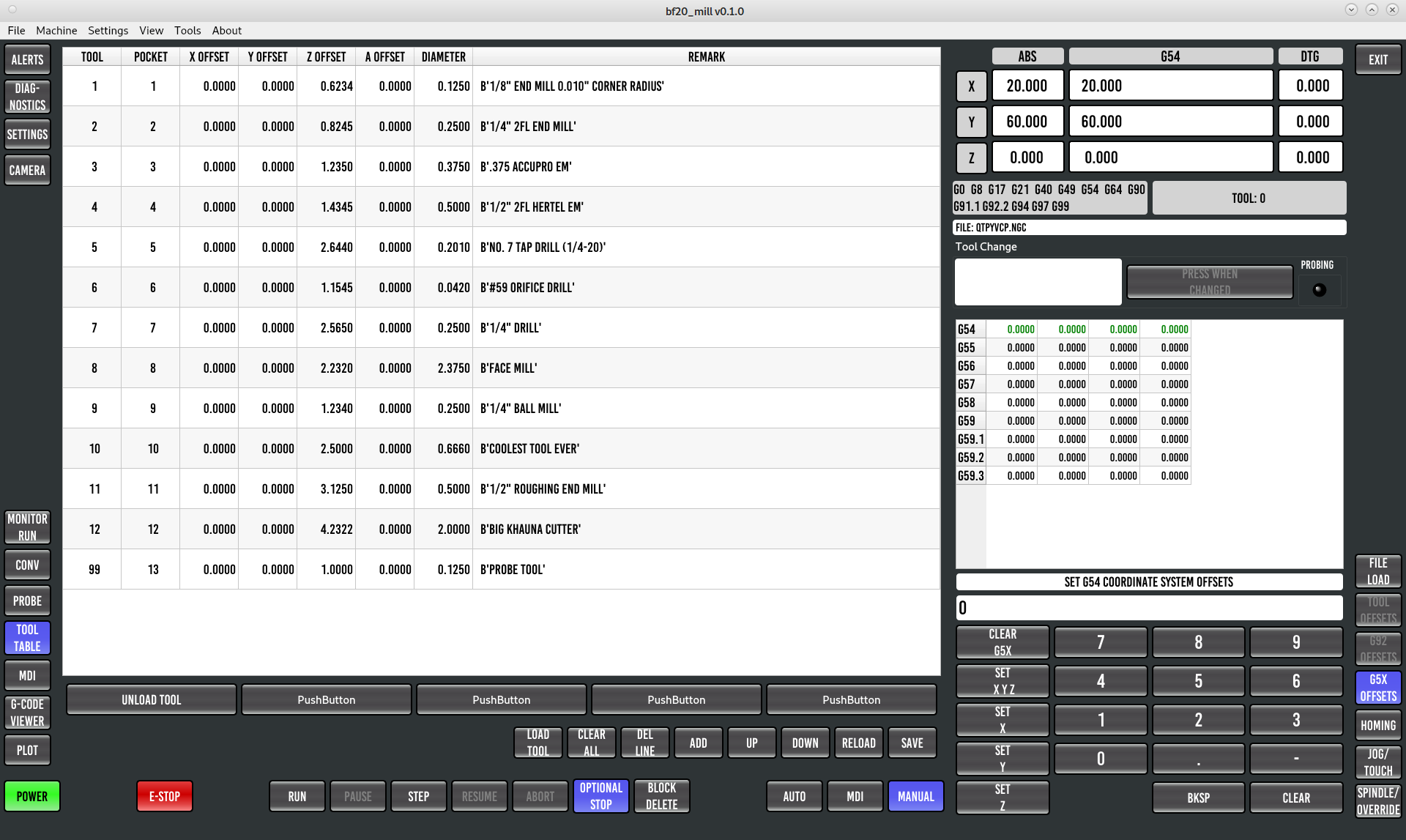

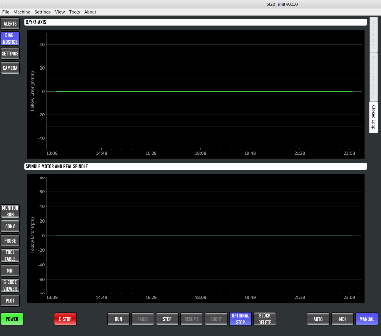

This is the UI I use on my Optimum BF20 mill. The mill has stepper motors but with linear glass scales which provide the absolute position feedback into the pid. I have some UI elements to assist in checking that feedback performance to ensure cutting operations are tracking within 0.01 - 0.03mm, particularly on finishing operations. I typically can get <=0.025mm tolerance with some proper thought on the CAM and order of operations.
Inspiration and support from work done by JT and Lcvette

That diagnostics screen is fantastic. Do want.

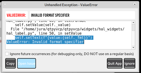

Hello! Please tell me how to open your interface in linuxcnc 2.9.0 pre. if possible. Upon attempt open I get an error like in the screenshot. Thanks!

There are two branches. One called "master" and another "master_py3". Active development is on the later and expects a working py3 environment. At the moment I have only tested/used master_py3 on Debian 11.

Nice work on the update to probe_basic. The status tab is perfect! I see this is an older post, but maybe you can share the update or some notes on how you made it. I want to create something very similar. Newbie here and not sure where to start.
