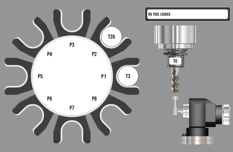

Hello,
on the ini ATC section by adding
8 pockets
16 pockets
requires latest development version of qtpyvcp and probe_basic

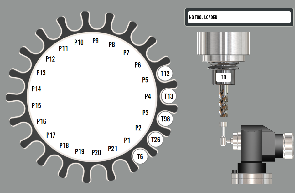

[ATC]
# Carousel image available for 8, 10, 12, 14, 16, 18, 20, 21, 24
POCKETS = 168 pockets
16 pockets
Last edit: 06 Sep 2020 01:42 by TurBoss.

Updated yesterday and it works fine after I added the section in the ini file.
Nice work!
