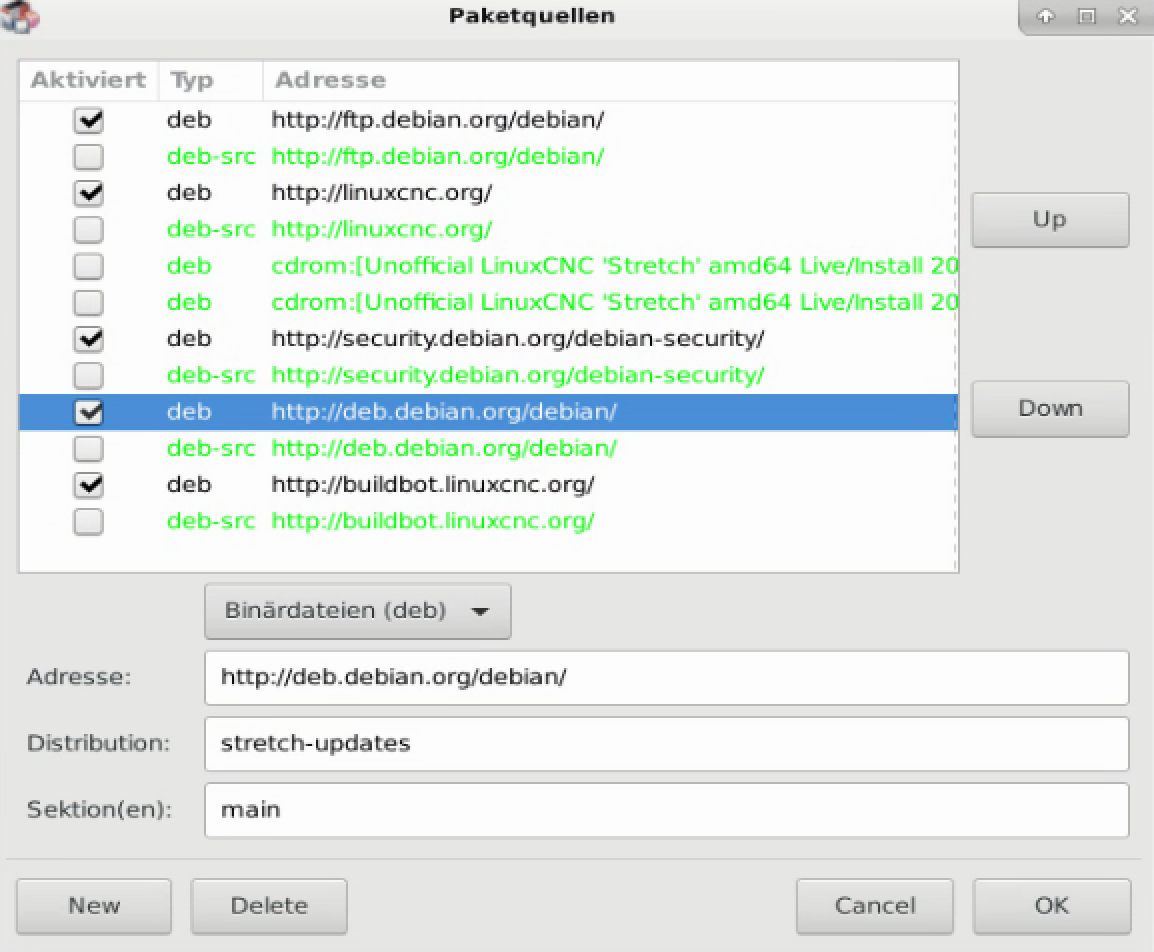

I changed only the apt repo to 2.8 linuxcnc and ran an update (all packages including the Debian ones maybe this was a mistake). No hardware changes
kernel: 4.9.0-13-rt-amd64
my apt sources
everything comes from the precompiled except some pythons modules I installed by pip and qtpyvcp, probe_basic and the hand wheel module

can you pleas show distribution field when you click on the linuxcnc build bot repo ?
and I'm not sure if is correct to have both repositories active :? can some one confirm?
deb linuxcnc.org/
deb buildbot.linuxcnc.org
edit: maybe try
pip install --upgrade vtk
Last edit: 12 Sep 2020 06:07 by TurBoss.
